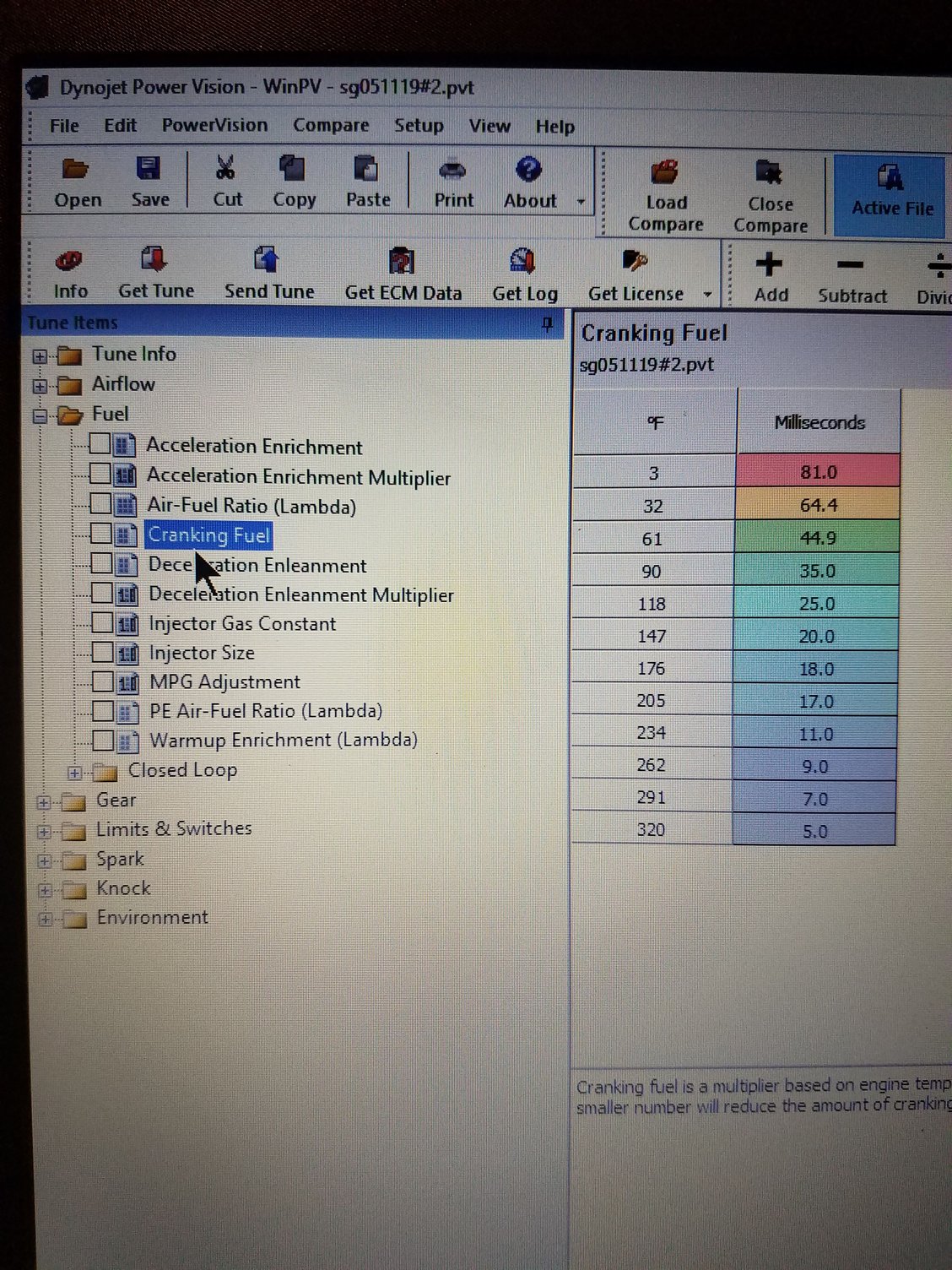

Cool High start up idle ...
Originally Posted by Stickman53
Hey Springers4ever....got a question for you since you've seen the stock tunes....my 2019 Road Glide rpm always shoots to 2400 the second it fires up... It drops right down in a couple seconds to a normal cold idle (around 1200 or so). It definitely shoots to 2400 with EVERY start. I'm in FL and don't ride below 70 deg so it can't be a cold weather setting. Is there something in the tune you've seen that will cause this?
thanks
As VDeuce has stated above...you can check the Crank to Run table ...but we would also check the Cranking Fuel Table ...as this is what shoots more fuel in during startup only ...in your case ...this may be a little to high ...causing the momentary high rev at start up ...
think of it like a carb bike ...you pump the throttle once or twice (to shoot fuel in from the accelerator pump) , crack the throttle open while starting ...this make the motor start reving high for just a moment ...
the Moco must inject a larger amount of fuel to get these bigger and bigger motors to start ...
