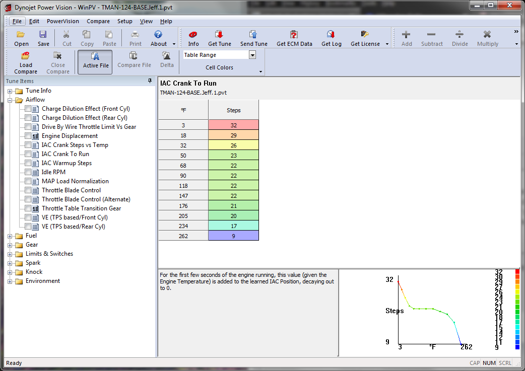

Hey Springers4ever....got a question for you since you've seen the stock tunes....my 2019 Road Glide rpm always shoots to 2400 the second it fires up... It drops right down in a couple seconds to a normal cold idle (around 1200 or so). It definitely shoots to 2400 with EVERY start. I'm in FL and don't ride below 70 deg so it can't be a cold weather setting. Is there something in the tune you've seen that will cause this?
thanks
That is controlled by the IAC Crank to Run table. Lower the values if you have a tuner that allows it. Note the description in the lower right.
