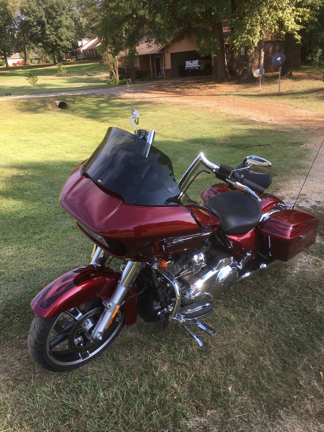

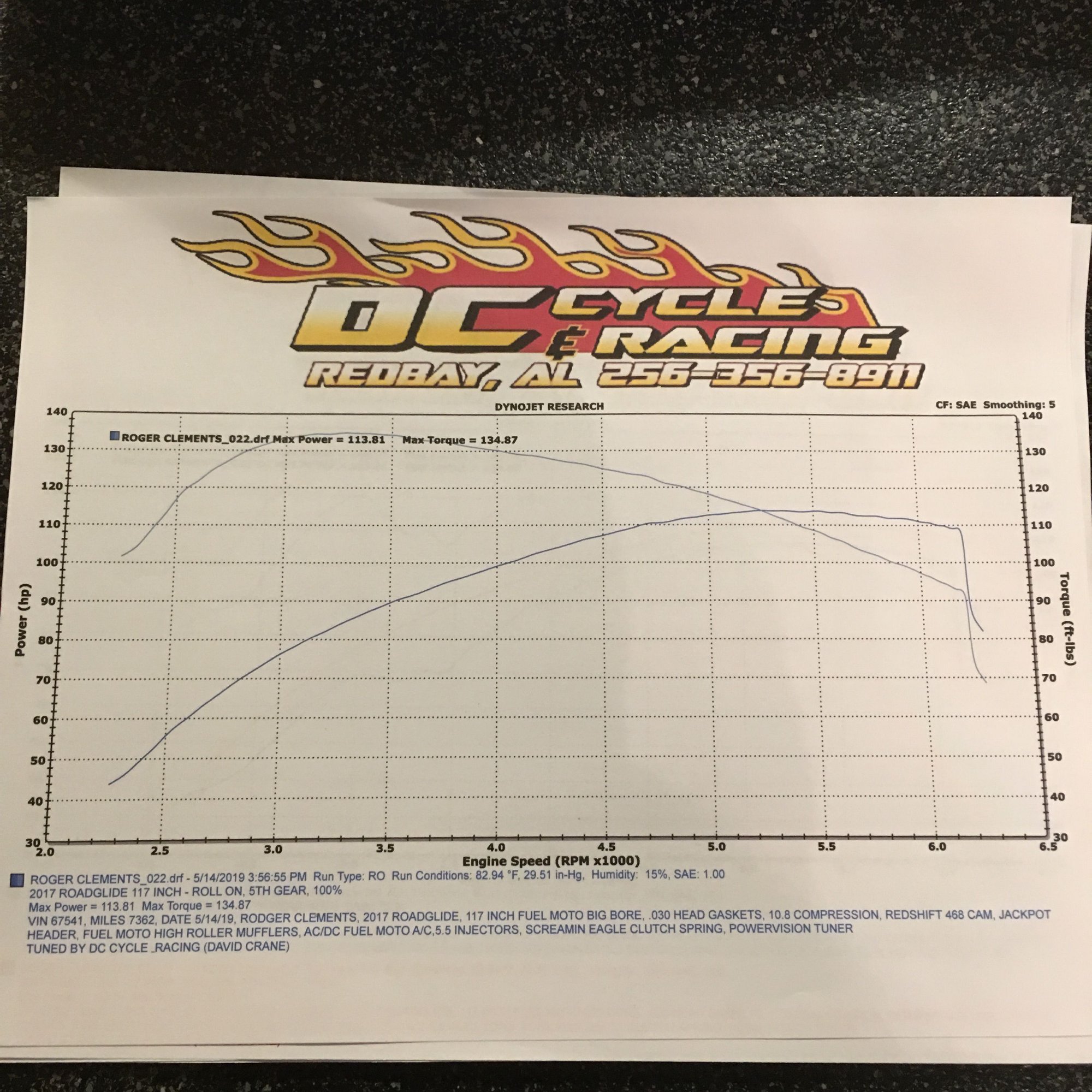

2017 Roadglide started as 107, now 117.
fuelmoto bigbore,redshift 468,fuelmoto 2 1 2 header with high rollers,ac/dc air cleaner,5.5 injectors.
I am really enjoying this build,there is other bikes that have more power.but I think this is the limit for me.
I have a really good dyno tuner that has did a couple of bikes for me and he doesn’t Disappoint.
like I said I may not have the highest numbers on this setup,just want a good strong bike.
goal Accomplished

Nice run.

Your tire budget just went through the roof.

Good lookin run there ,sharp sled too!
