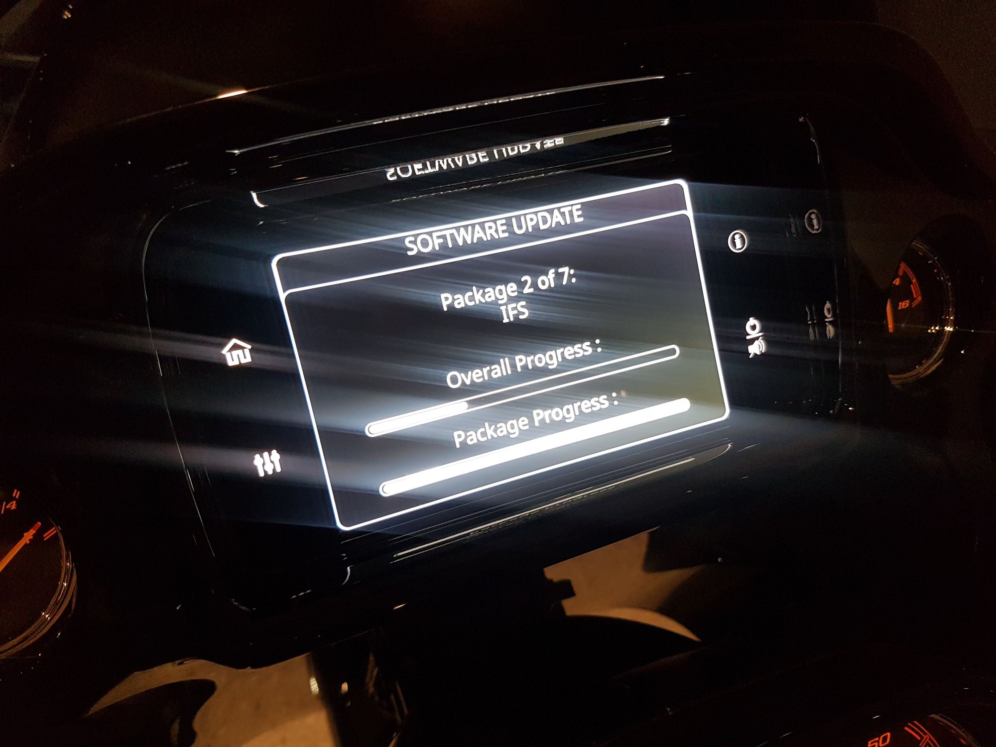

My 2019 Road Glide Special had an outdated software version and so I thought I would download the new version (MY20.19.20.01) and upload it into my motorcycle.
I downloaded the file from the Harley Australia website, unzipped the folder and copied the contents onto a 3.0 USB flash drive that was just reformatted and empty.
I set my ignition to 'accessory mode' and plug the USB flash drive into my bike. The bike recognises the drive immediately and starts uploading packages 1 of 7. After it finishes uploading package 2 of 7, I see the following error message "Software installation processes was interrupted. Please leave ignition switch in accessory position and re-insert the USB device". I have attached some photos to see.
At this point, Im stuck. I tried different USB flash drives from 16GB capacity through to 128GB but none of these make a difference - I still see an error message after it finishes uploading package 2 of 7.
I am going to buy a 2.0 USB flash drive tomorrow to see if that works but if this fails, I am out of ideas.
Any advice from anyone who has experience with this issue would be greatly appreciated.

If a dealer is open, you can usually get them to install system updates.

Latest update is Version: M20.19.39.00. I would try this instead.

I would do a full format and then down load again.
