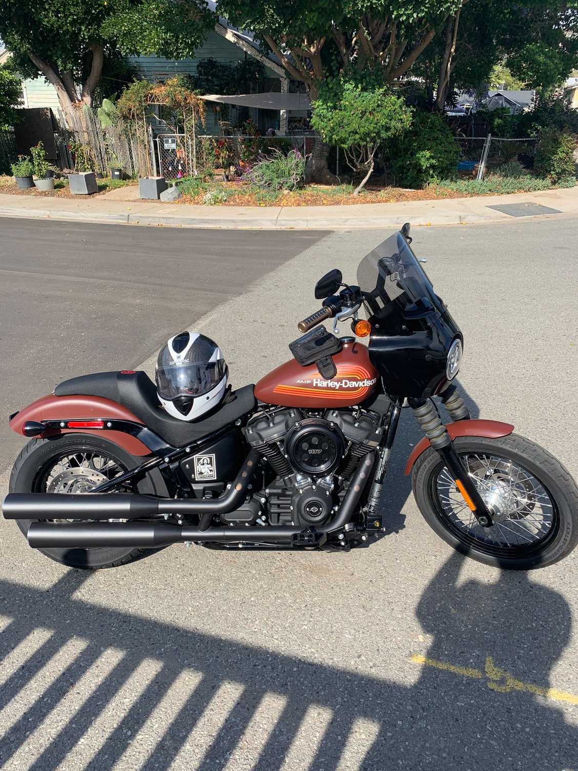

Hi guys:
My name is Craig and I just picked up a ne 2018 Street Bob! I love the bike and have made its ergonomics right for me with a Whiplash saddle, some Lucky Dave’s San Diego bats and a Memphis fairing.
My other bike is a tuned and very loud and fast 2017 Aprilia RSV4- i don’t expect my Harley to be that bike anymore than I expect my GT500 Mustang track car to be my Cayman. However- I can never leave well enough alone and I want my Harley to be louder and faster and want more power especially up in the rev range. (I’m also going to upgrade the suspension but that’s another topic.)
In short- I don’t really care about low rev torque or how the bike pulls when it’s in the wrong gear. I tend to ring my vehicles out and coming from sport bikes this thing has amazing low end torque already it just dies as revs increase.

My 1976 Sportster tank looked like yours but in black.
I'm thinking I don't need one of the popular "torque" cams for my lightweight (for a Harley) bike.
If I keep the RPM's up just a bit a cam like the S&S 475 should be just the ticket, since for now I want to keep my bike a 107" and not pull the heads off for high lift springs, so want a "bolt in" cam.
