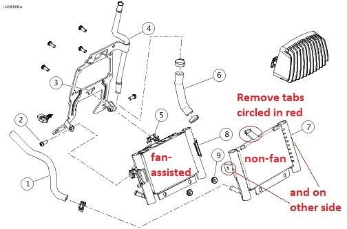

Originally Posted by craigffb
Can either of you guys give a little more info on this?
Thanks
Just figured I didn't need to have two oil coolers. Pretty simple process, remove the factory oil cooler, cut off the tabs for mounting and Snap-on the fan. Touched up paint where I cut off the tabs. Reinstall oil cooler with two new clamps on the bottom of the hoses only and plug in.
Had the dealer turn on the option 4 fan. Not really a flash, just like turning on speakers or turning on lights on brights and stuff.

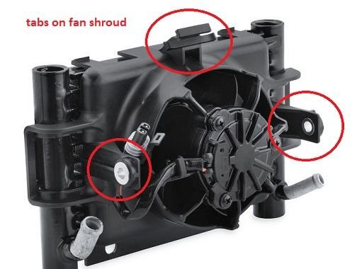

i.e. The mounting tabs on the non-fan oil cooler are in the way of the fan shroud. The fan-assisted oil cooler moves the mounting tabs from the oil cooler to the fan shroud (meaning the oil cooler itself does not need mounting tabs).
Non-fan oil cooler: 62700196
Fan-assisted oil cooler: 62700133
Fan: 26800095
Fan-assisted oil cooler kit (fan and fan-friendly oil cooler): 62700204
