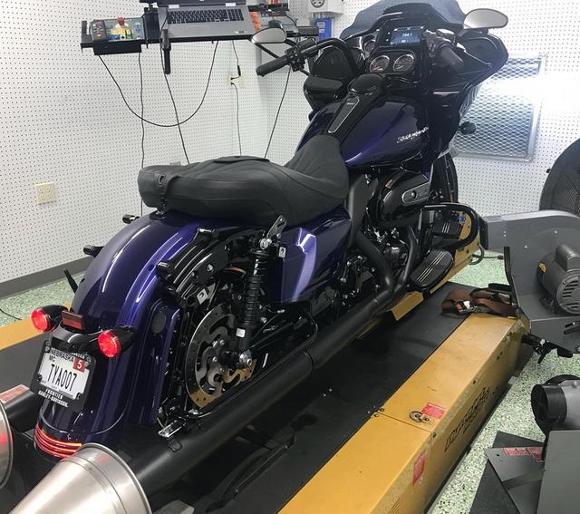

We have a 2020 Road Glide in our shop this week. We are doing some Dynojet Power Vision tune validation and a FM 128 big bore build. Stay tuned!

shouldn't that be a 128 kit on a 114?
I would love to do a 128 kit on my bike but since it has 34k miles on it I am not sure thats a good idea

Why wouldnt it be a good idea? Freshen up the pistons, jugs, lifters, cam, etc etc

just worried about the strain it would put on the rest of the drivetrain.

Yes, it will be a 128"
Would not worry about 34K miles if the bike is good service condition.
