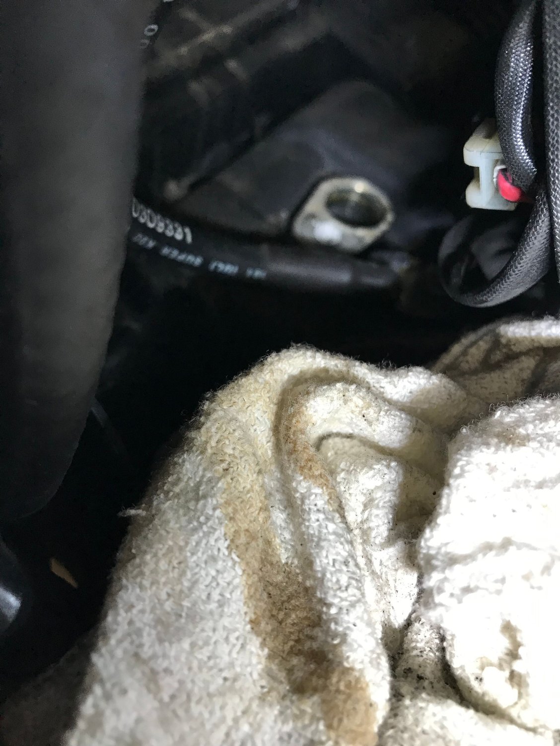

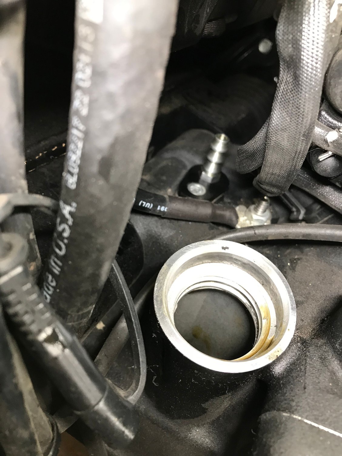

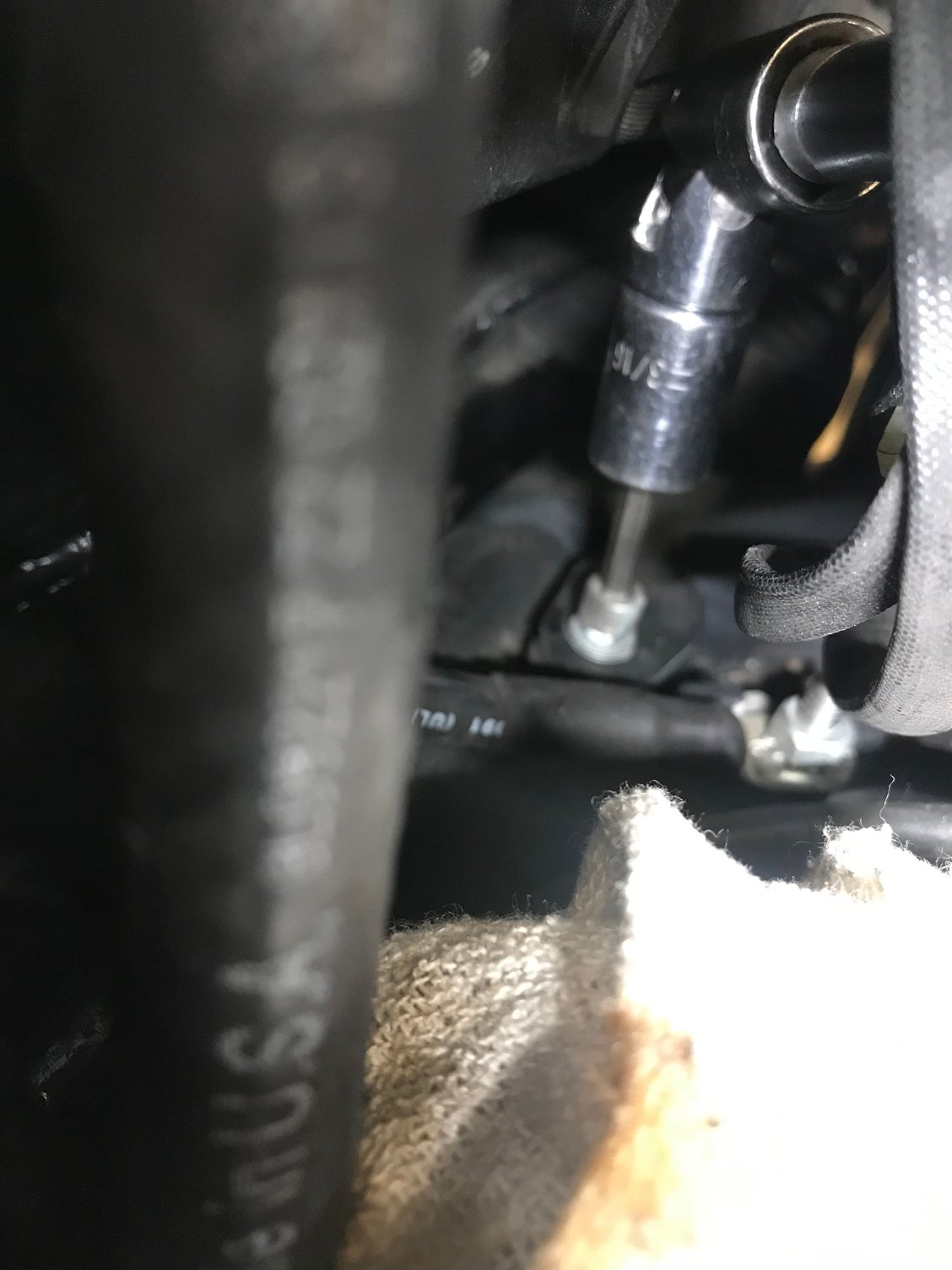

Default M8 water cooled 10min oil vent
Ok warranty freaks...may as well move on .....this is not for you or will i debate it........ Just dont know if anybody has done this way instead of quicky oil cap vent or expensive billet oil cap vent thats on the market....Simple plug in top middle of trans goes direct to oil pan / tank in trans. 3/16 allen pull plug. Drill out plug for simple fitting...i use 3/8 fitting. Piece of 3/8 gas/oil line. I do wipe all lettering off the line with a bit of carb cleaner....for good reason. This one snuck rite thru a warranty claim while he was on the road...lmao. He had and oil presure sender go bad and we had not put a gauge on like i have done most of them. Tech never saw it and off he went free free free....but tech did set tires for him....24 in rear 39 front. Good reason to stay out of dealerships and recheck everything....even if you didnt ask them to do it....they need to burn time.
price you ask? 3.65 for filter hose and fitting. Took all of ten mins. Put something in oil fill if you have to take it out so you dont drop anything in hole.....my friggin hands were to big to do the job without removal. Have 3 like this plus the vented to atmosphere heads. No oil smell....none use a drop of oil between oil changes. We only run 3.2 quarts of oil now in all of them. Hey just showing what we do for a few pennies. Almost nobody notices it either
