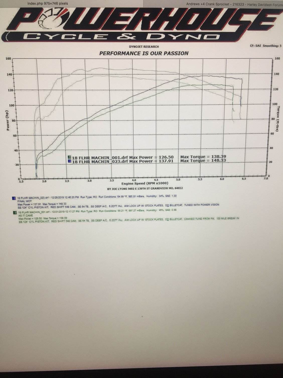

Got a RS 548 nib if you want more left side 25 intake close, stock heads in example below

Default Rs448
[QUOTE=yobtaf103;18772161]Got a RS 548 nib if you want more left side 25 intake close, stock heads in example below
this is my 18 road king with the S&S power package. In addition stage 1 heads, HPI 58MM, S&S intake, 6.1 injectors, recluse clutch, and S&S 2-1 exhaust. I'd love to replace that 550 S&S and see what I can get out of that RS 448.
Jeffs96 PM me, think you need to get post count up 1st
