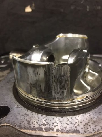

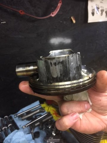

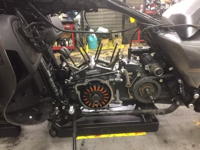

I have just returned from the shop to check on my bike. I will ride it this afternoon.
It turns out that the 3rd bike with the 114 inch stage kit that sumped had the latest new 8 lobe 2020 pump installed at the time of the upgrade. This is the first instance that I have heard of a failure with the new pump. After talking with the mechanics I was not encouraged, as the redesign may not be enough to cure the problem.
Here are the pictures of the sumping stock 2019 CVO with a partial tear down. I took some close ups of the pistons. You will note that the skirts are cracked on both pistons, with portions of the skirt actually broken off.
Bad piston 1
Partial tear down of sumping bike
Bad piston
Partial tear down 2

Originally Posted by Cruiser1
"More bad news"
Bad piston 1
Bad piston
Partial tear down 2
A few questions:
- By chance did the mechanics reference if the piston oil jets were leaking?
- Is the shop that did the install of the original 2020 oil pump upgrade, the same one doing the teardown?
- Do you know for a fact that the engine with the 2020 8-lobe oil pump that failed was due to sumping and not some other cause?
- If it failed from sumping, they should have a record of the ounces of oil they drained from the Crank Position Sensor before they started the tear down.
- Can you ask how much oil was in the crankcase when they drained it?
