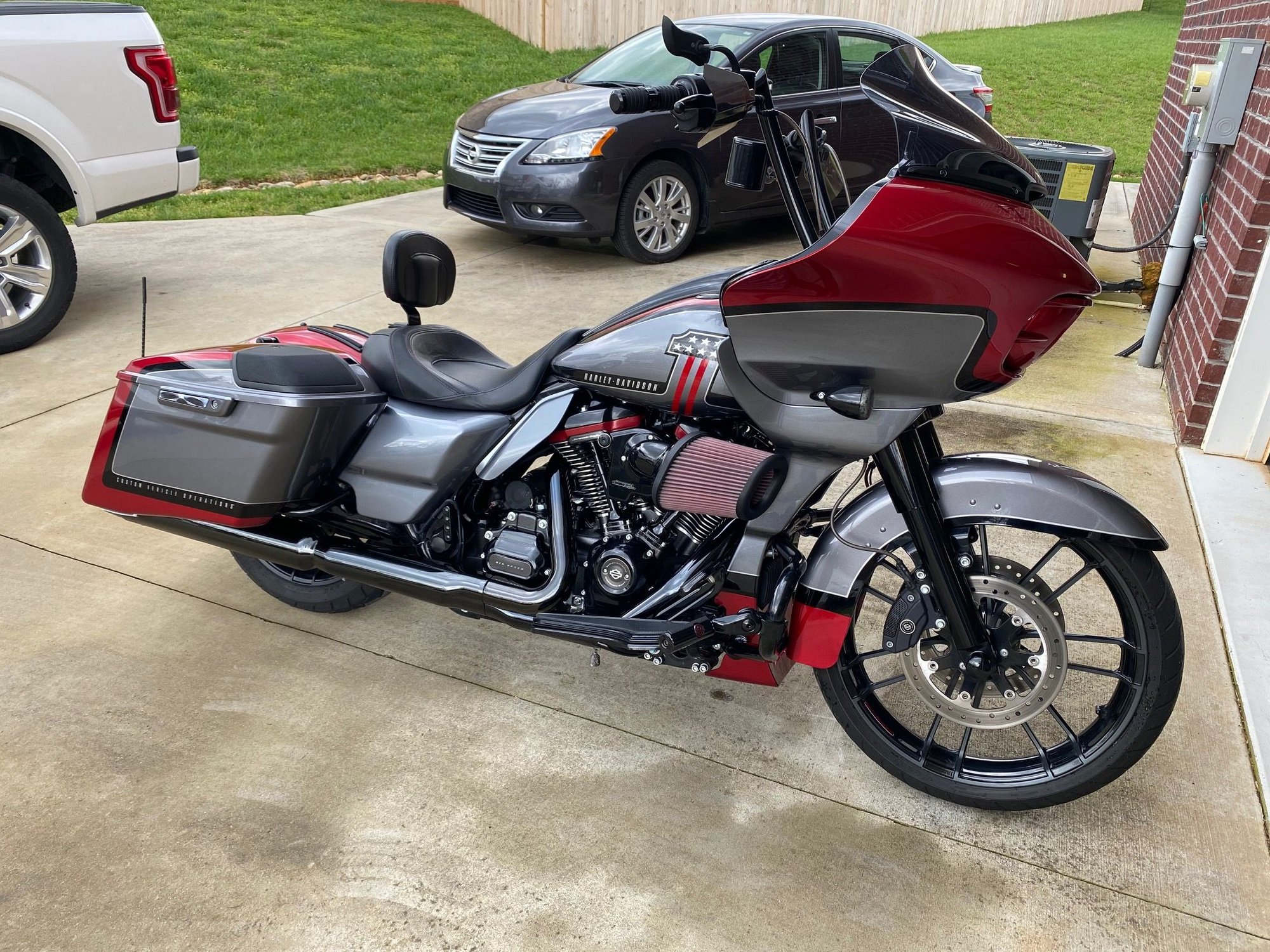

Finished my build on Wednesday, and rode it home from friends house where we built it. I have 120 miles on motor, and hope to get another 100 today, that should have it at close to 300 when it hits the dyno to be tuned.
My build:
S&S granit cylinders, bored to give 130 inches
Mahle flat top pistons, set at 0 deck height.
Heads by HD Street Performance
Adjustable rocker arms
CR-482 cam
HPI 62mm throttle body
HPI port matched intake
6.1 injectors
S &S lifter cuffs
H-D 8 lobe oil pump, the 2020 version
Recluse torque drive clutch
Fullsac head pipe and 2.25 baffles.
Can't wait for the tune.
