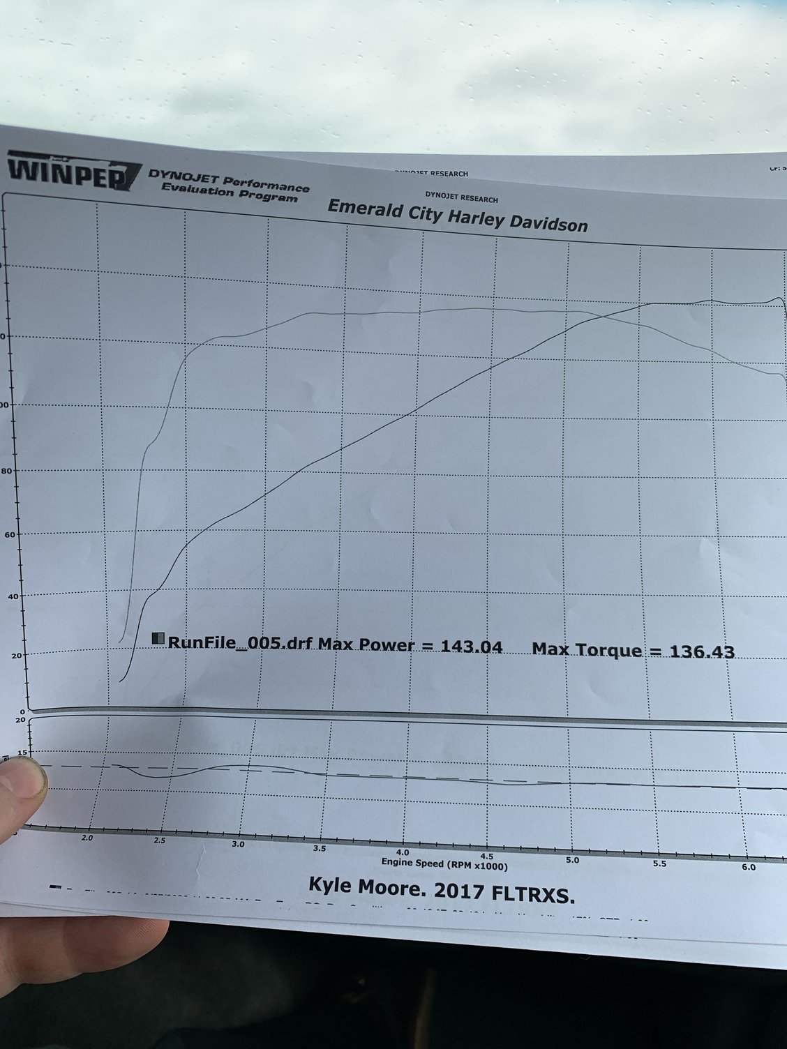

Thanks for hijacking my thread with your superior build, 12 to 1 on pump gas? In an air cooled engine? Or are you using corn fuel?
Just got mine back. Ended up at 143hp and 137ft lbs. Makes 120+ft lbs from 2500 to 6000. Ridiculous torque 😎 Harley should make them like this from the factory.

SS 124 (11:1 compression)
S&S 550C cam, lifters and pushrods
Fuel Moto A heads with the woods springs
Ward CNC manifold
SE 64mm TB
Fuel Moto Ventilator air cleaner
D&D Billet cat
5.5 FM injectors
AIM SDR and heavy springs
S&S oil pump and cam plate
S&S rocker studs, head bolts, and tappet cuffs
I think the 408 cam from woods or Fuelling 521 probably would of did better on torque but I love how the 550 cam sounds and it came in the engine kit and I didn’t wanna spend another 300 bucks on a cam to get maybe 5 more ft lbs down low.
Very nice build. Sorry about highjacking your thread. Not my intentent. Your build is very good, and will be a lot better on clutch, belt and transmission.
As for pump gas at 12.1 to 1 yes, no problem at all. It depends on cam, duration and overlap. Stock CCP is 226 to 229 do to variance in production line. My bike is 228 CCP.
The M8 is more tolerant of higher compression due to the 4 valve heads. My TC build is 11.4 to 1 and its much finicky about the gas I use. Have to have pure gas at 93 for it to not ping.

I was just kidding. I just went with a combo I knew would work, it’s basically the same build Fuel Moto does but with the S&S cam instead. You put a lot more effort into thinking yours through. I wrench for a living and just wanna ride it mostly, I like working in it sometimes but I didn’t really wanna mess around with part combos experimenting.
