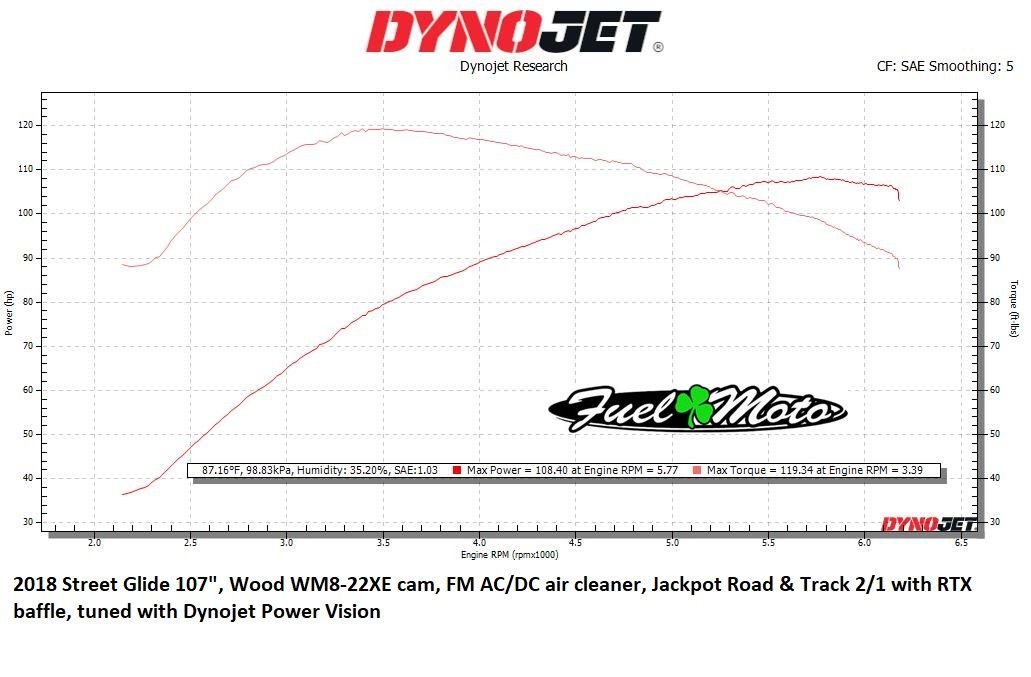

Here is a 107" bike we just finished up with the Wood WM8-22XE and our Jackpot Road & Track 2/1 exhaust with the RTX baffle

WOW!!! went to your website and saw the map below..impressive..glad to see this cam can be installed on the 107 M8...
