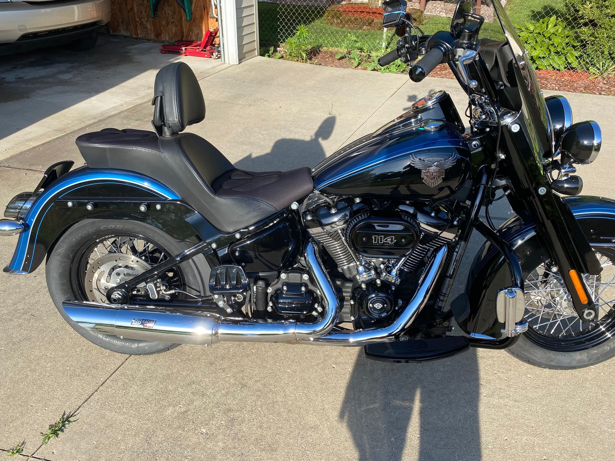

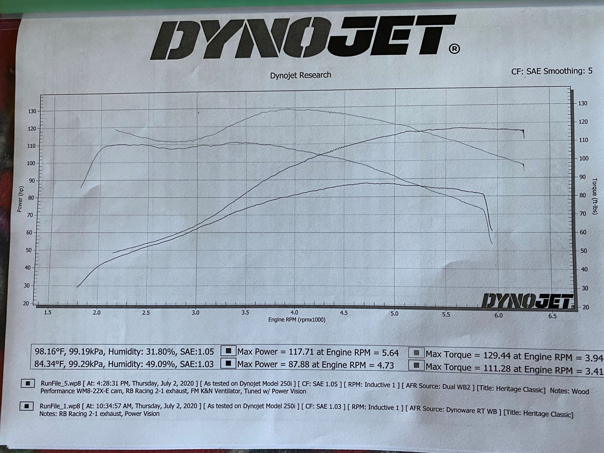

Originally Posted by StevieRay59
I'm having Fuel Moto install this cam July 2nd in my 2018 Heritage FLHCS 114 ci. I have the RB Racing 2into 1 Black Hole pipe on my bike. I will let you know how it turns out.
I'm sure it will be big improvement over stock cam. Steve
Here are the results. Very happy camper. Bike is runing great. Thank you Fuel Moto, another satisfied customer. Steve

Very nice, TY for posting!
