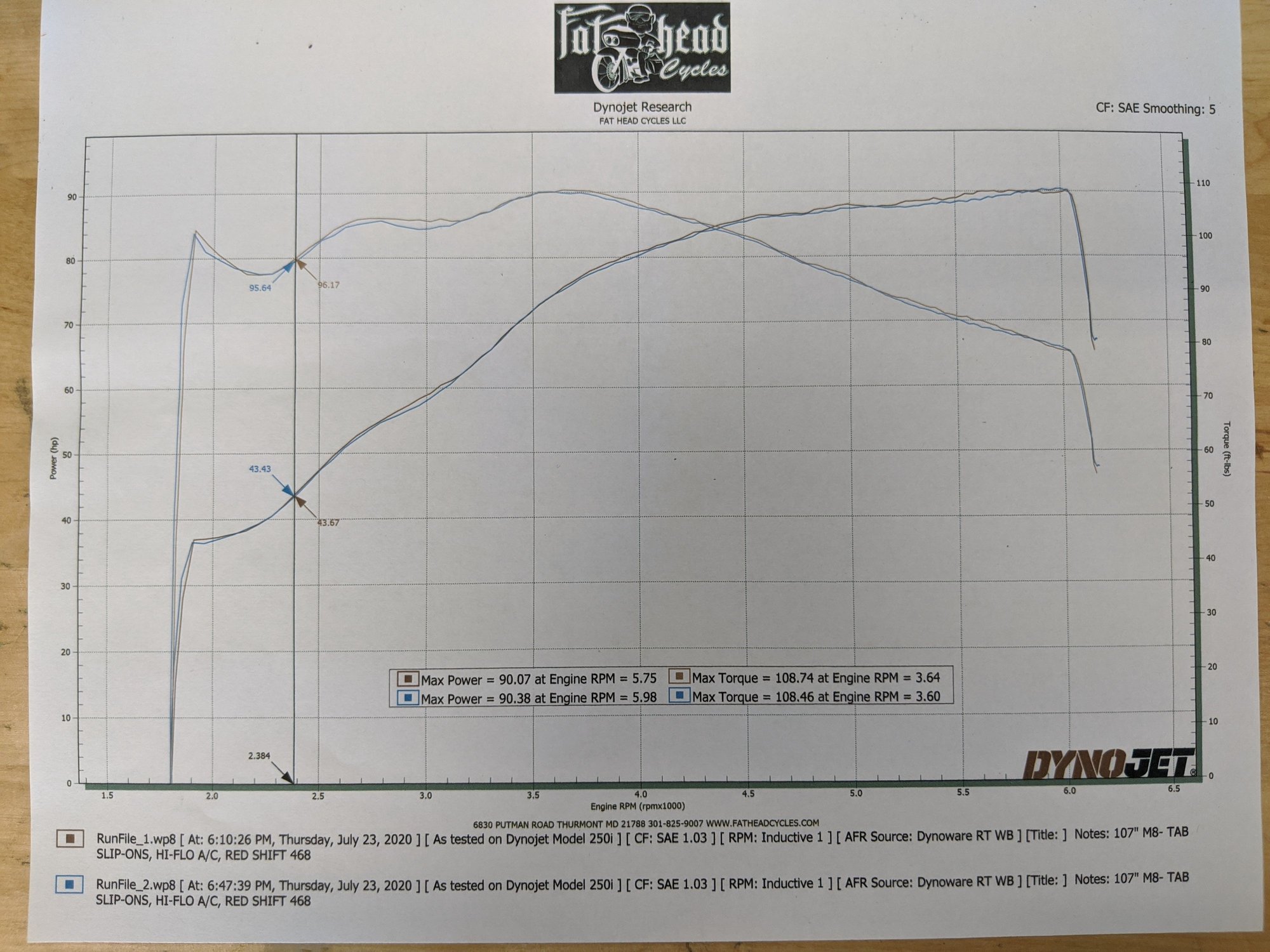

I have the 4.5" BAM sticks with Zombie baffles, Zippers RS468 cam, SE intake, and dynotuned using Powervision, sounds amazing and a hell of a difference in performance. The numbers weren't as high as I was expecting and he said that was due to the stock head pipe, so that will come next. My only concern will be how much louder it will get, I may switch over to the 2.5 baffles once I get a head pipe but we'll see.

Do you have dyno numbers? I'm looking to do cam, oil pump, exhaust, a/c, pushrods, etc. this winter. Went from a 1994 dyna to a 2017 FLHX. Loved the sound of my vance and hines straight pipes on the old Evo. Not sure if I want to sacrifice the low end for sound and roll with the Zombies or go for a 2/1. Your setup is very similar to what I'm looking at. Just need someone to push me one way or the other. Are the Zombies really that loud? The videos sound pretty good, but you know how the audio on videos never does any setup any justice.

They assured me there’s a lot left if I change out the head pipe and retune but in the meantime she’s still pretty nasty.
