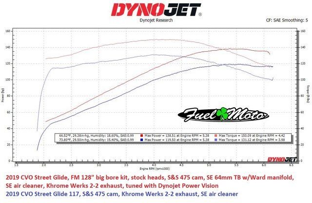

Originally Posted by Deuce Dave 2003
I just bought a 2017 Road King with 6,000 miles on it with Rineharts. Looking hard at the 475 cam, but not hearing anything good about Rinehart slip ons with it. Doing a full stage 2 with an eye towards a 124” big bore for next winter. Does anyone run Rinehart slip ons with a 475 C out there? I plan on a PV tuner purchase also.
I have not ran Rinehart's but I recently had an FM 128 done and I kept the 475 cam I had. I am very happy with the results and this cam worked awesome in the big bore! Good luck sir with whatever you choose going forward.
