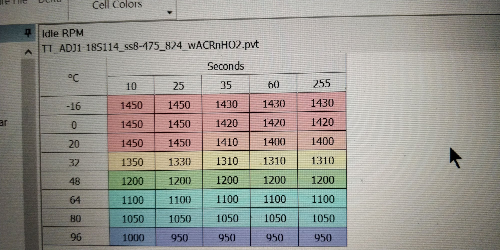

Could someone who is running a 475c cam and a PV post up a pic of there RPM Idle setting from there tune ,I struggling to get mine set right tried multiple setting but it still just a little off.

It will hold the target rpm I have ajusted the scale so much just want to get back to the original settings with the 475c a rpm of 950 seams a little low.
If you don't mind anouther question when I auto tune and save the file if I look at the VE settings there still the same ?
Thanks for your support

This is what I ajusted to today?

Here's mine. What problem are you having?
Just trying to get the lope of the cam at idle to be a little smoother
I'm going to copy yours I think it will be a smoother transition between temperatures as my last two columns there was too much of a difference so it's causing my idle to bounce

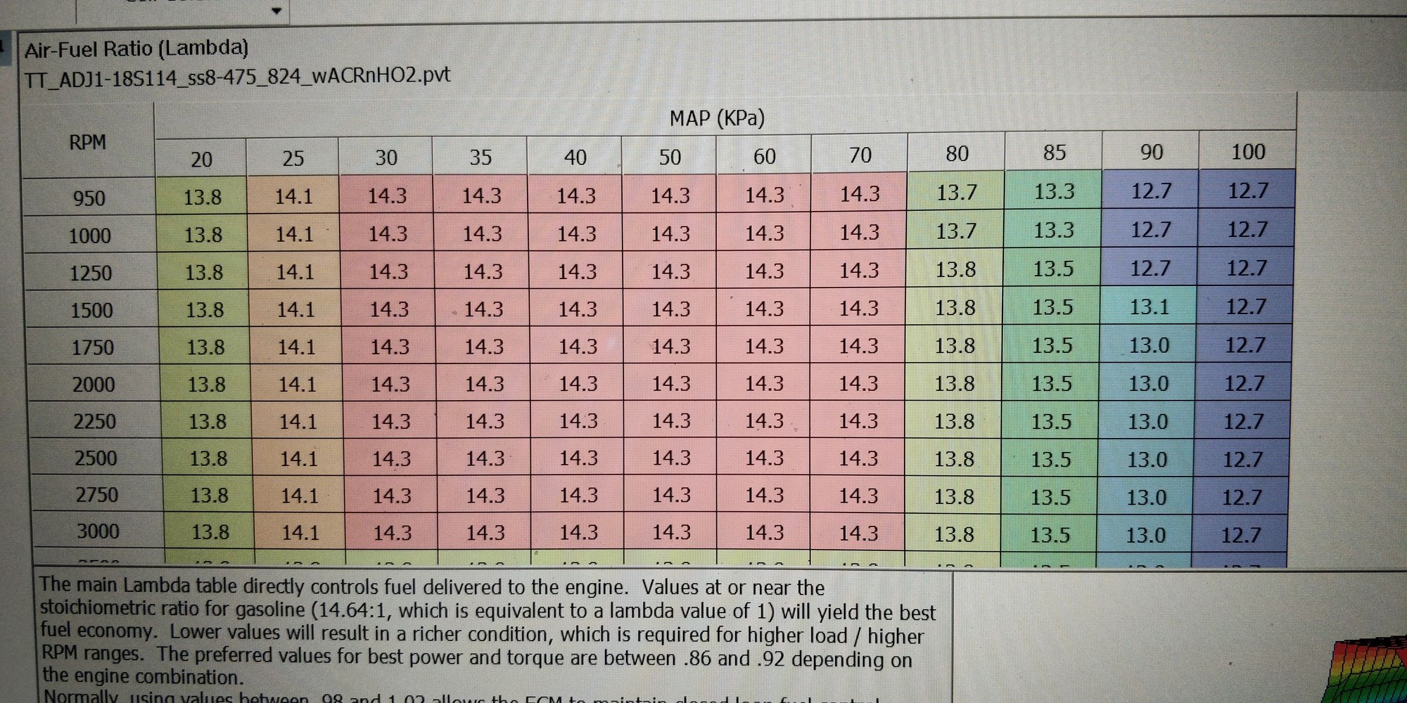

This is my air fuel ratio lambda does it look normal?
Old Dec 3, 2020 | 09:28 AM
Issysportster's Avatar
Issysportster
Joined: Aug 2019
Posts: 273
Likes: 150
From: Colorado
Idle speed adjustments will not help much with what you are describing. That is getting the VE's dialed in and A/F mixture settings.
Old Dec 3, 2020 | 09:30 AM
SoCaRider's Avatar
SoCaRider
Joined: Feb 2020
Posts: 615
Likes: 209
From: California
Ok that's been a challenge for me ,I just posted that ratio can you look please and see if it's somewhat close
The way that cam is made I don't think you will get a smooth idle with it. That is what made my decision on the 475, performance plus idle lope.
