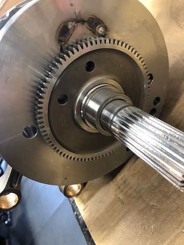

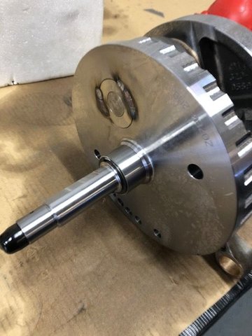

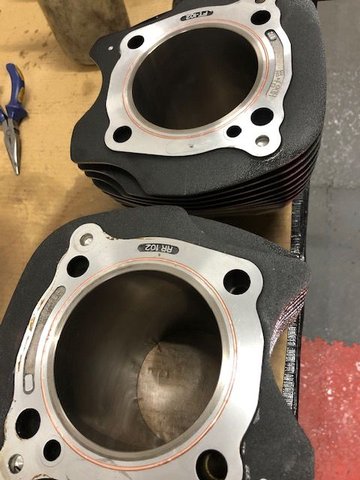

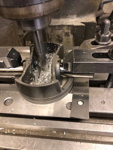

I chose an S & S crank and rods and additionally welded the big end journal, S & S oil pump, a new set of 117 pistons and gasflowing the heads and fitting 1mm o/s valves I had great success running copper O rings to seal the head gaskets in conjunction with Cometic head gaskets. 1.5 mm base gaskets to lower the compression.
What was good to see was that on glaze busting the barrels to bed in the new rings I found the bore was in perfect condition with no distortion or wear on the thrust faces. Good job Harley! I was really impressed by the quality of the Mahle SE 117 pistons, we don't need to go big and have wafer thin sleeves in the barrels, why slog huge pistons creating all the crankcase pressure problems caused buy them. The lovely thing about going supercharged is the engine has an easier time than stock when your not asking for power, lower compression pistons, not huge high comp pistons that are giving the motor a hard time all the time, No huge high lift cams and heavy valves springs. The superb Rotrex design means off load the supercharger takes very little power to turn it, and through its 10:1 step up gearbox and Planetary roller gearbox it can spin to 120,000 rpm with no noise and fantastic power gains from idle.

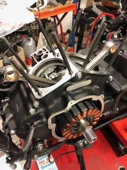

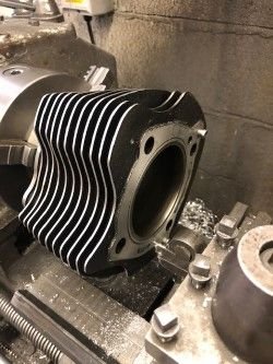

Below are photo's of the crank, O ringed barrels, piston machining to clear the small end of the conrods.

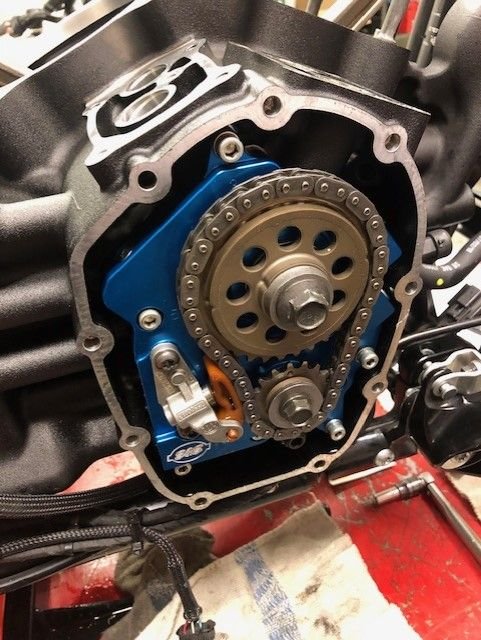

With this build we will generate a lot of heat so we are going to run a big oil cooler. So an S&S pump having bigger rotors will help with the flow.
