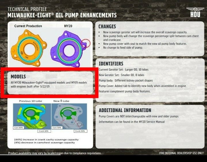

Originally Posted by Ironworker69
Apparently 5/19 is the magic date, you could check the number on the engine and call Harley
No 5/19 is am approximate date. With the things like this there is no real exact day. HD will use upo the pumps in line until the lat one is gone. then switch to the new one. Bad oil pump is not a safety Issue so they will use what they already have a deal with it latter.
Old Dec 11, 2021 | 02:45 PM
barneyboy's Avatar
barneyboy
Joined: Dec 2017
Posts: 5,076
Likes: 3,293
From: Plover, WI
According to this internal publication from HD, there is an exact day.
