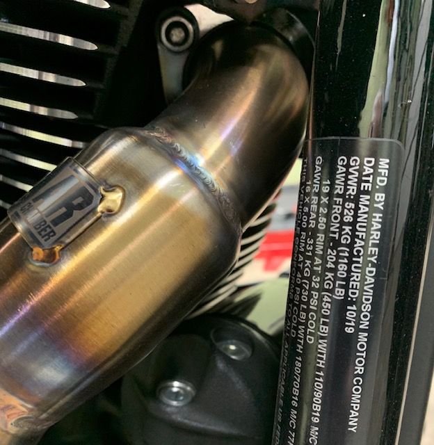

Originally Posted by 19BluMxRG
That im not sure. Ive tried looking up what month my bike was manufactured but never found anything.
On Softail I found my date here:
So is that just the frame build date or will that coincide with engine build date as well?

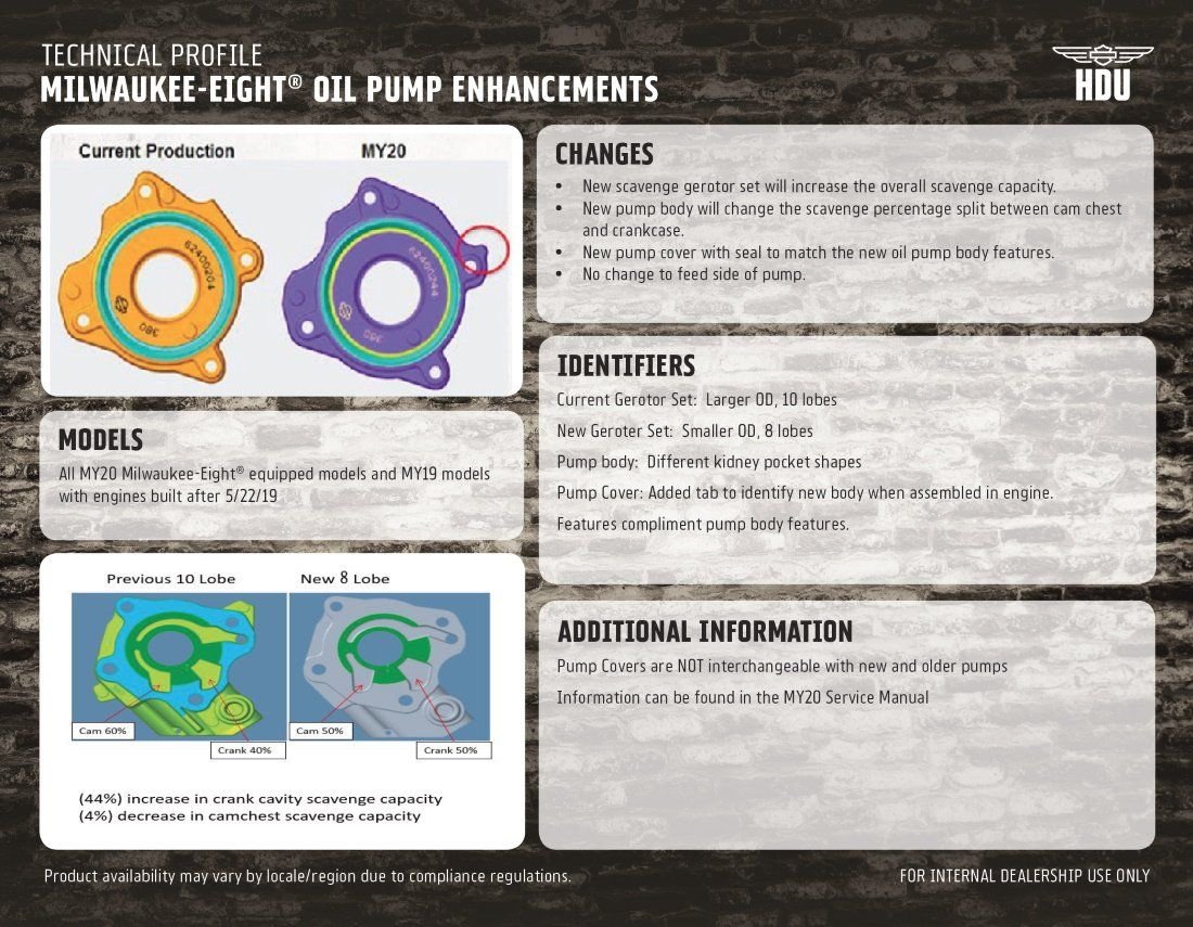

Old Jul 21, 2021 | 06:27 PM
OldMike's Avatar
OldMike
Joined: Feb 2009
Posts: 5,642
Likes: 1,985
From: Cleveland Zoo
We've been using it as motorcycle build date, I don't know of a separate engine build date.
Here's more info in this PDF and picture:
M1450.pdf

So i ended up putting the 20MY pump in it and we will see what happens. If that doesnt fix it then ill just ride it until it grenades or until next spring, whichever comes first.
