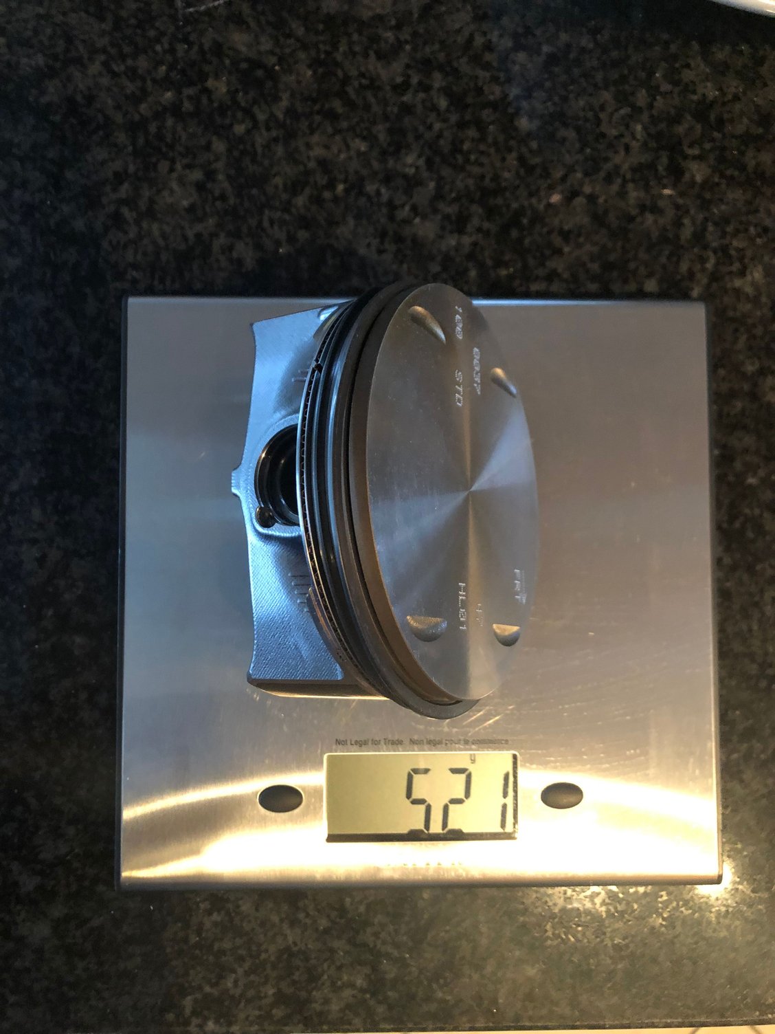

May not help but a stock 2020 107 piston, wrist pin, and rings = 521g. Free bump though.
