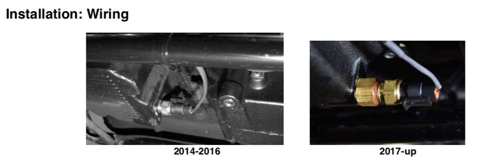

not sure what factory confirmed it for you but the one that made mine supplied a sensor and adaptor and the following instructions to fit my 2017 FLHXS

Thanks for posting, now I see what the difference. DDG changed how they do this now. They don't supply the adapter any longer. Even revised their manual vs. yours. I'm going to call them back and see if I can get the adapter.

you're welcome, I suspected a change... but at least you now know how it was done Oct 2020 (when I got mine).

I believe they have two sensors now. The MLX-8414 kit comes with the one that will fit without an adapter and is 3/8" male NPT.
