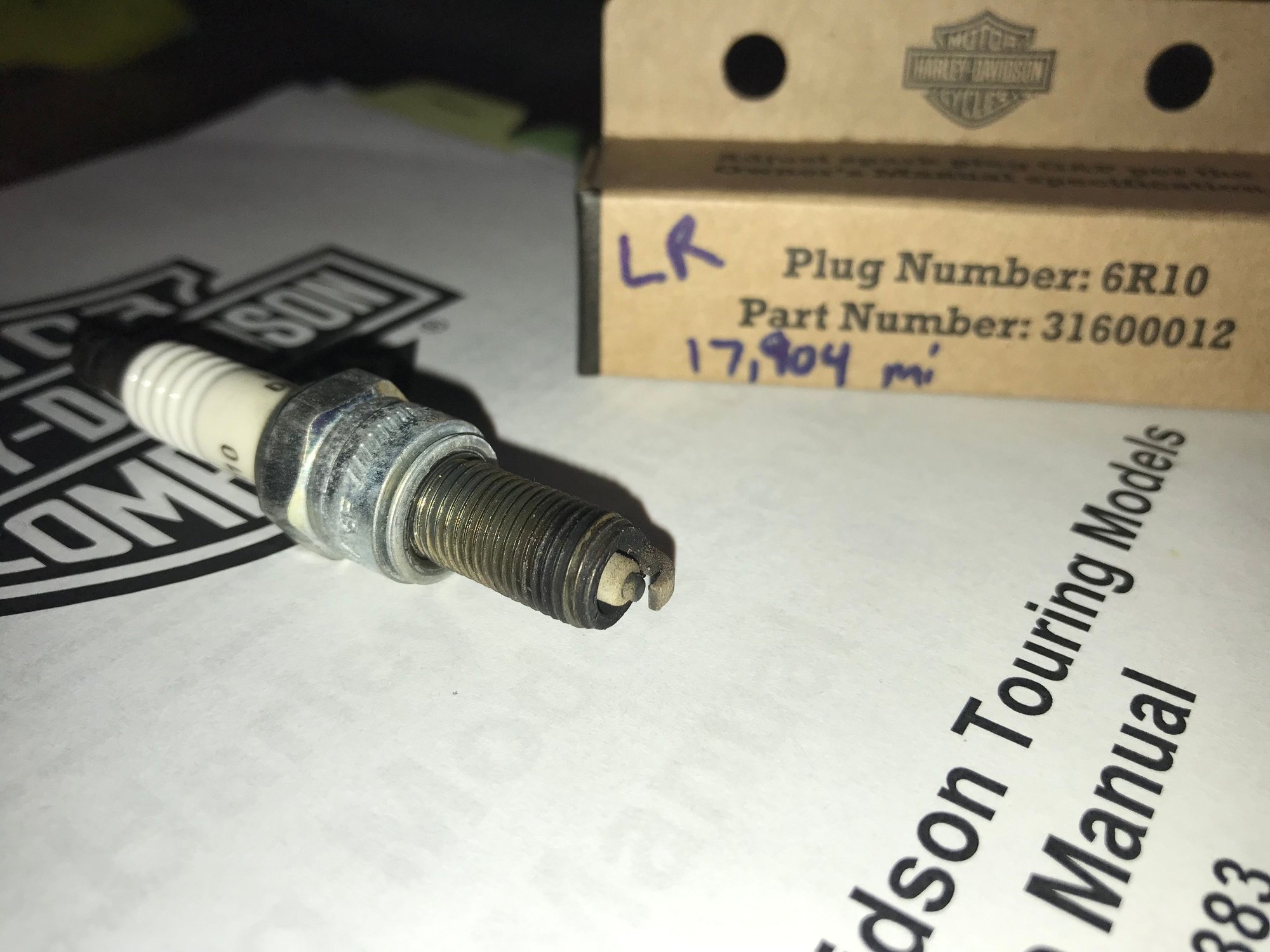

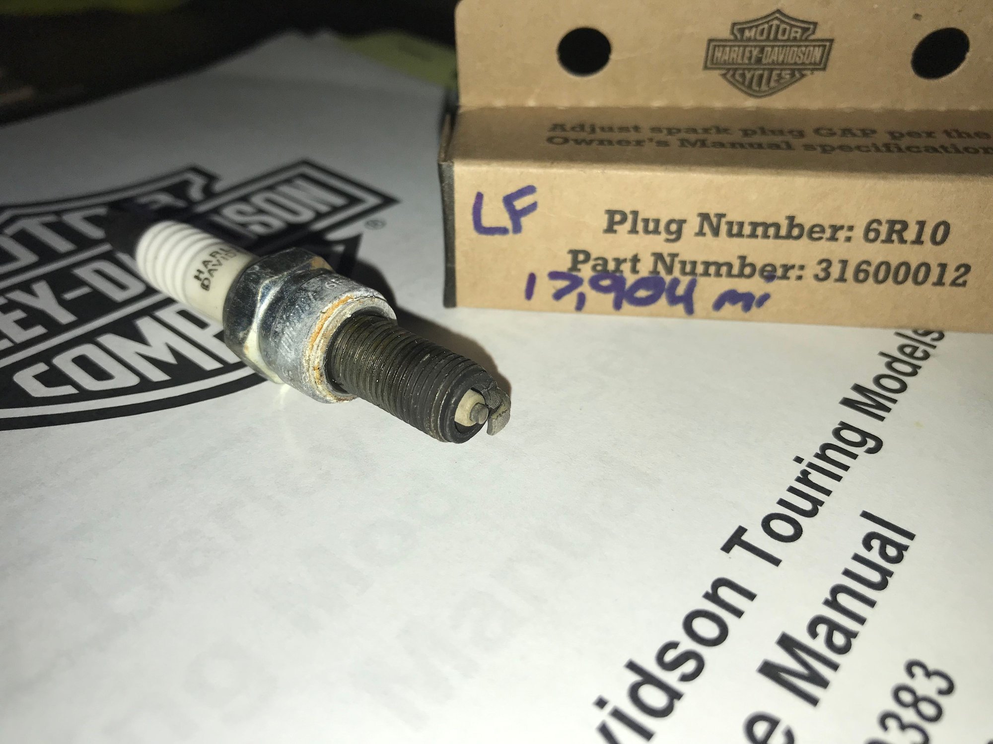

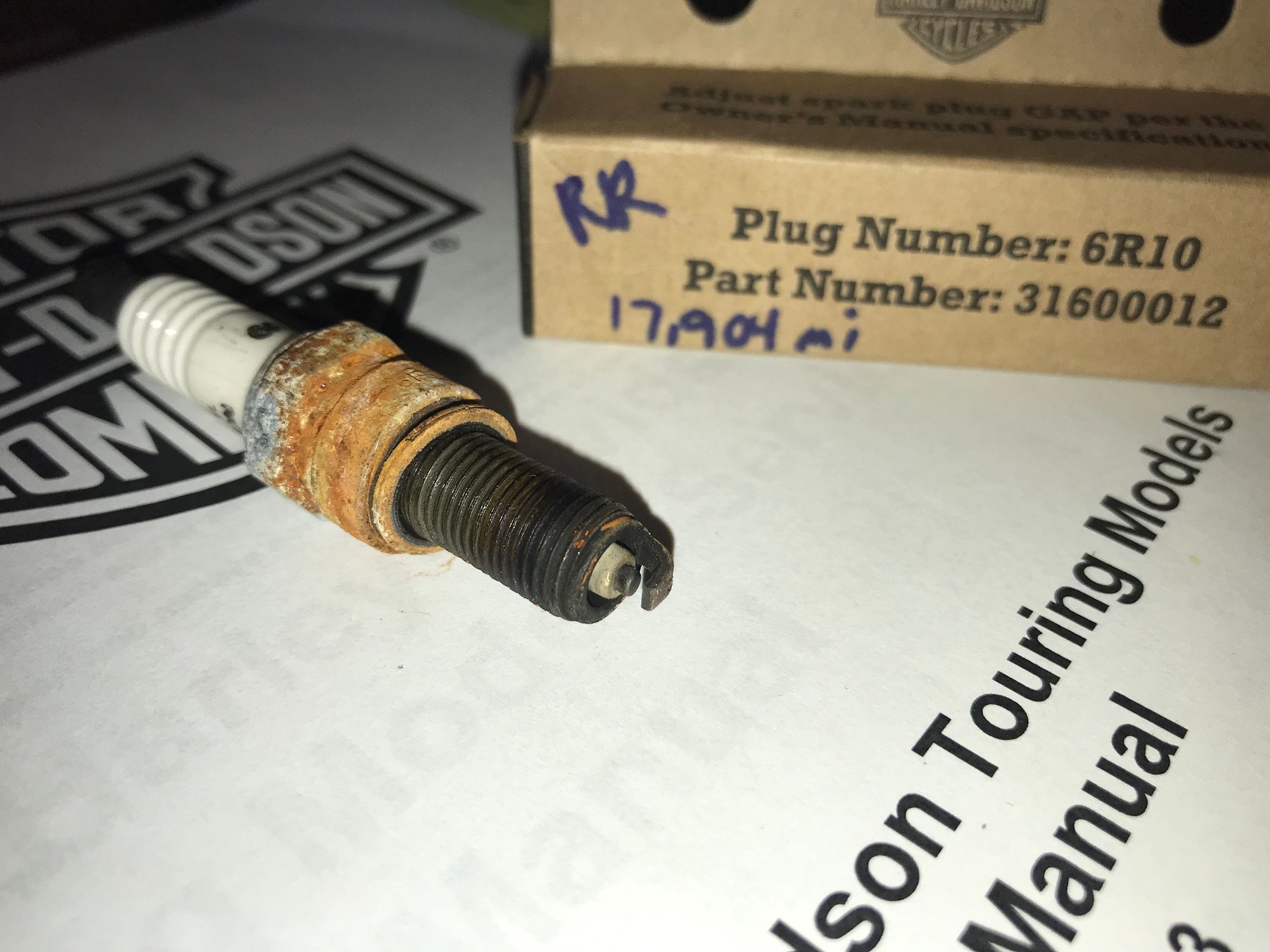

Here's what mine looked like. First post is after 2 years, 18k miles. Second post is after 2 years, 8k miles. The only issue I see with them is the amount of corrosion on the plugs on top of the engine as it traps water - no issue with the actual function of the plug. They were not difficult to remove as I torque to spec and use anti-seize as the service manual states (I know the newer service manuals have removed this).
Forgot to add picture of spark plugs
