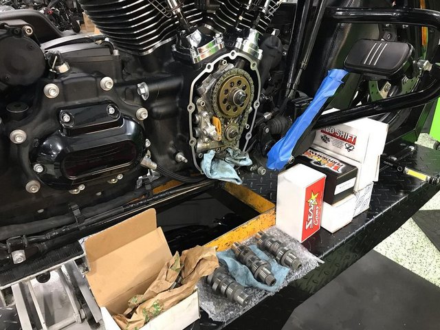

Another series of Milwaukee-8 cam testing is well underway; in this round we’re testing about a dozen of latest & most popular bolt in performance camshafts. Each cam will be tested under the same test procedure in our climate controlled dyno cell. Test bike is a 2022 114” FLHRS equipped with Jackpot RTX 2/1 exhaust, H-D Ventilator air cleaner with our BMF element, stock throttle body with S&S 55 manifold, and each cam will be fully tuned with Dynojet Power Vision. Testing will take about a week and we’ll need a little time to compile all of the data. Stay tuned!

2023 H-D Milwaukee-EightŽ 114″ Camshaft Shootout
In this latest 2023 round of Harley Davidson Milwaukee 8 cam testing we installed and evaluated 10 of the latest, most popular bolt in M8 camshafts. The grinds tested are marketed as performance cams for 107″,114″, & 117″ engines.
Our test bike was a 2022 Harley-Davidson Road King equipped with 114″ engine and RDRS, the bike was equipped with a H-D Ventilator Stage 1 air cleaner with Fuel Moto BMF air cleaner element, stock throttle body with S&S 55mm intake manifold, Fuel Moto 5.5 fuel injectors, Jackpot RTX full length 2/1 exhaust system, and each cam was fully tuned with Dynojet Power Vision. The tests were performed over a four day period in our climate controlled dyno cell in no particular order. The following cams were included in this test:
