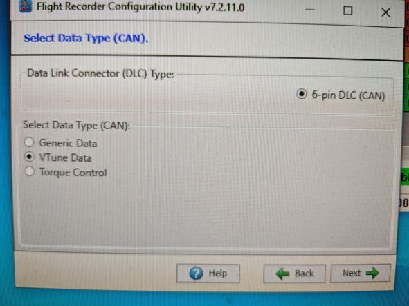

Originally Posted by Lonewolf176
Also when you flash the map
Pretty sure I had all of these checked the last time but we'll find out after the rain clears.

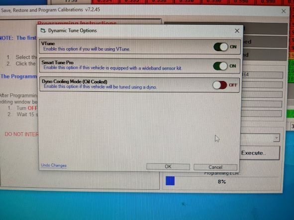

I think you have to deselect the vtune button.
When I set up flight recorder?
Old Mar 19, 2023 | 03:54 PM
  #44
Lonewolf176's Avatar
Lonewolf176
Joined: Sep 2007
Posts: 2,467
Likes: 677
From: Vancouver Island B.C.
On the drop down when you flash the calibration. I'm not by the dyno to look at all the drop down menus.
But Vtune says the first step is to program the vehicle with a Vtune-enabled MT9 calibration?

Oops, I used the wrong pic. Should've been this one.
I can leave this completely unchecked and collect both narrowband and broadband data. I know checking vtune sets it up for narrowbands. I would just leave the smartune pro checked and try collecting data on a short run. Sorry for the confusion.

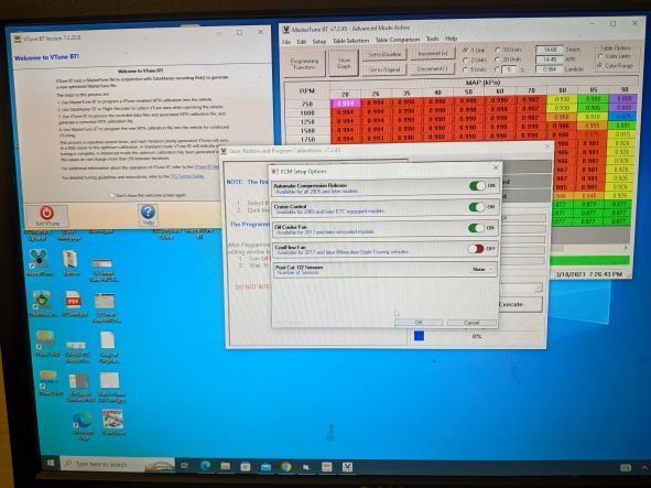

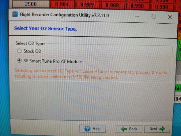

Okay, so that didn't work...
I called TTS and they had me email the OEM calibration as well as the current TTS calibration, Vtune and flight recorder logs.

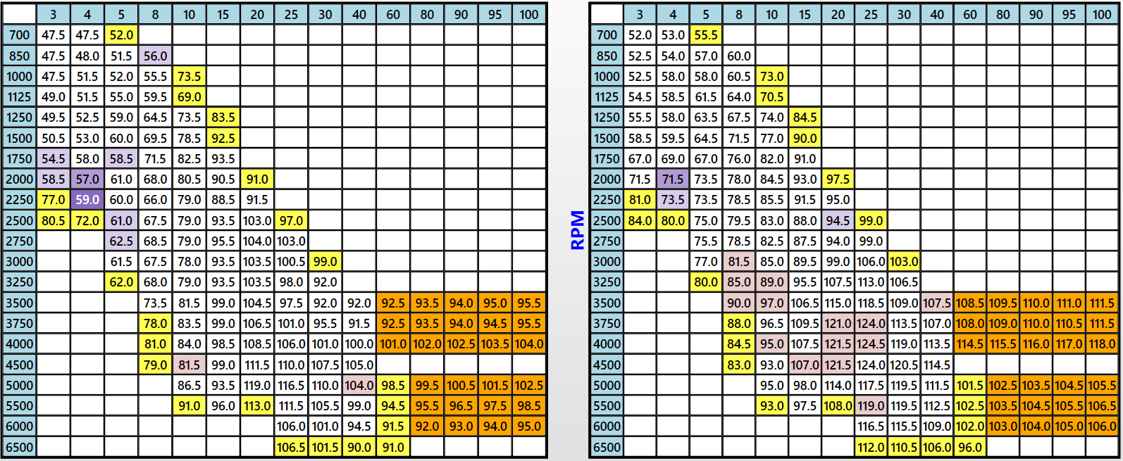

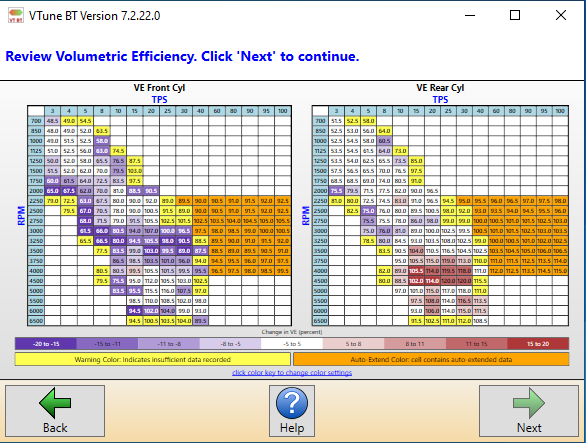

So I hooked the OEM O2 sensors back up and started over, with Vtune suggesting the above, which I accepted.
Not going to worry about the FIDC until I get the bike on a dyno...
VE changes after the first ride.
VE changes after the second ride.
I'm going to finish the OEM O2 sensor Vtune process with it this time and hopefully TTS gets back to me soon with a fix for the blank Smart Tune Pro VE tables...
