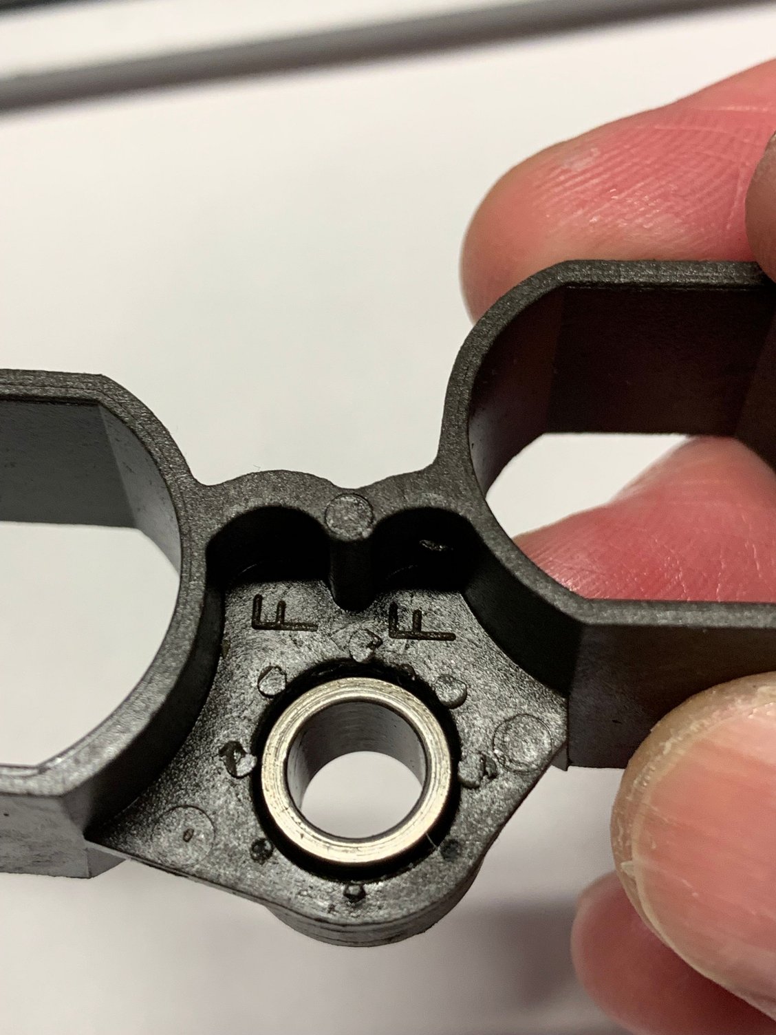

I din’t think the lifter cuff is supposed to be moveable by hand either.
i also think there was either extra thread locker crap in the bottom of the bolt hole or almost like they used so much thread locker and it dried while they were driving the bolt on and so they didn’t tighten it completely.
Since I was able to move cuff by hand I tried to see if I can tighten the bolt and sure enough the bolt got a
bit tighter. Once tightened I didn’t try to see if the plastic cuff could still be moved since by then I already decided to replace rhem
here are some pics of the lifter cuff
Notice the metal ring fits really loosely inside the plastic cuff. It’s loose but doesn’t come out
Bolt inserted from the bottom of the cuff. You can see the metal sleeve is just a tad taller than the plastic cuff
From the top of the cuff where the bolt head would be. I think those little nubs around the metal sleeve are what prevents the cuff from moving when the bolt is tightened. On mine they look a little bit worn
