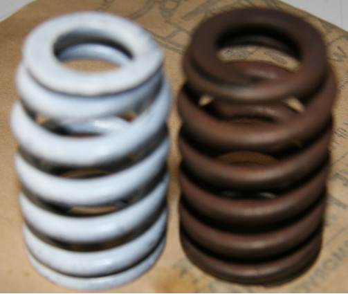

2023 121 cu in VVT valve spring data.
The white spring on the left stock 121 VVT spring, the the right spring is a current TTS replacement spring.
2023 121 cu in VVT valve spring is very close to the TTS spring other than white paint.
We check the spring pressures and compared them. Below are the results.
2023 121 OEM Spring
1.55" height 57.4 lbs
1.535" height 63.6 lbs
.950" height 235 lbs
.900" coil bind.
TTS Spring
1.55" height 58 lbs
1.535" height 62 lbs
.950" height 210 lbs
.900" coil bind.
Since the new springs are near identical to ours, that let's us know the they will handle a cam that has a valve lift of 0.580" when set up properly, but so far we have not gotten the piston to valve clearances to determine the limits there.

The white paint comes off those springs, not sure why they used em

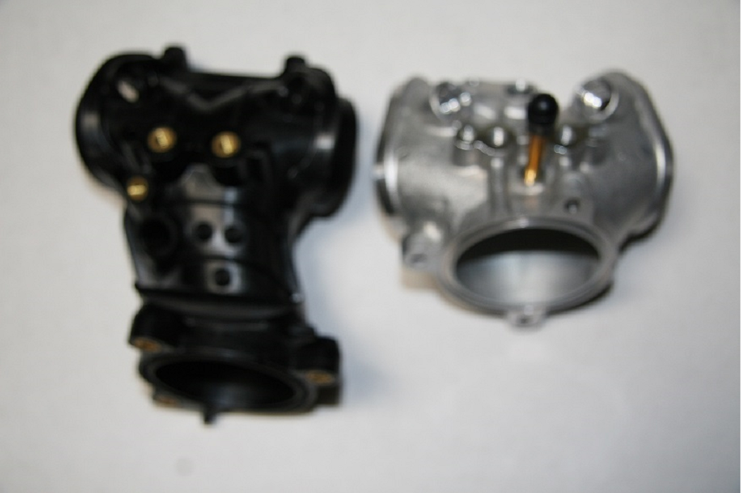

The current OEM M8 Intake is plastic on the left and the New OEM 2023 121 VVT Aluminum on the right
The new Intake is much shorter, which allows the Air Cleaner area to not stick out as far as before for better leg clearance while riding.
