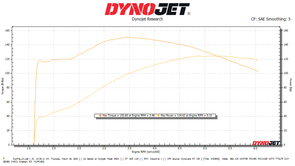

Here's one from Durwood.
Here's one I did

For the same or less money a 128 kit will blow away your 114 with head work and give you more power everywhere. They don’t even recommend head work on the 10.75 to 1 128 kit.
