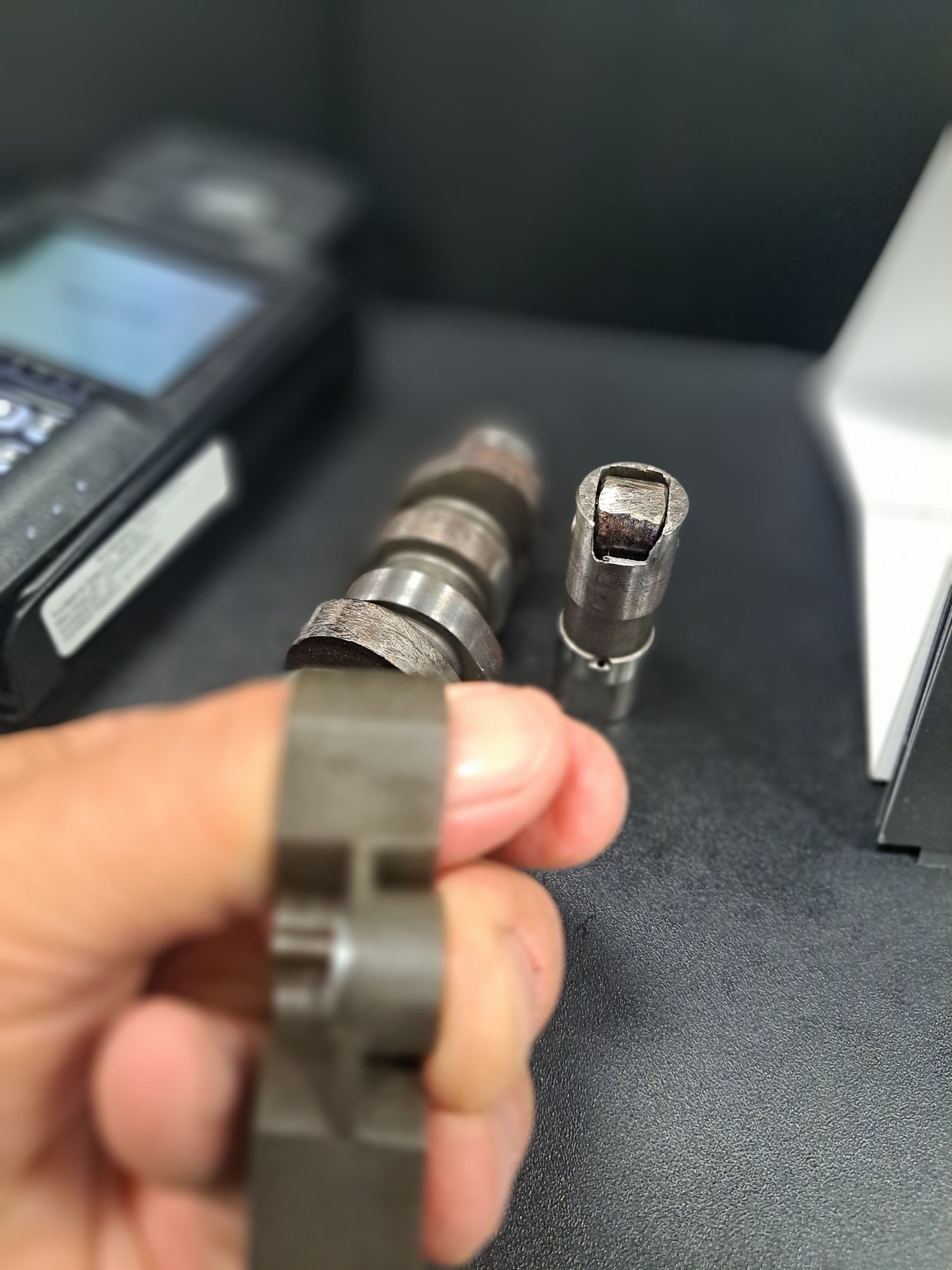

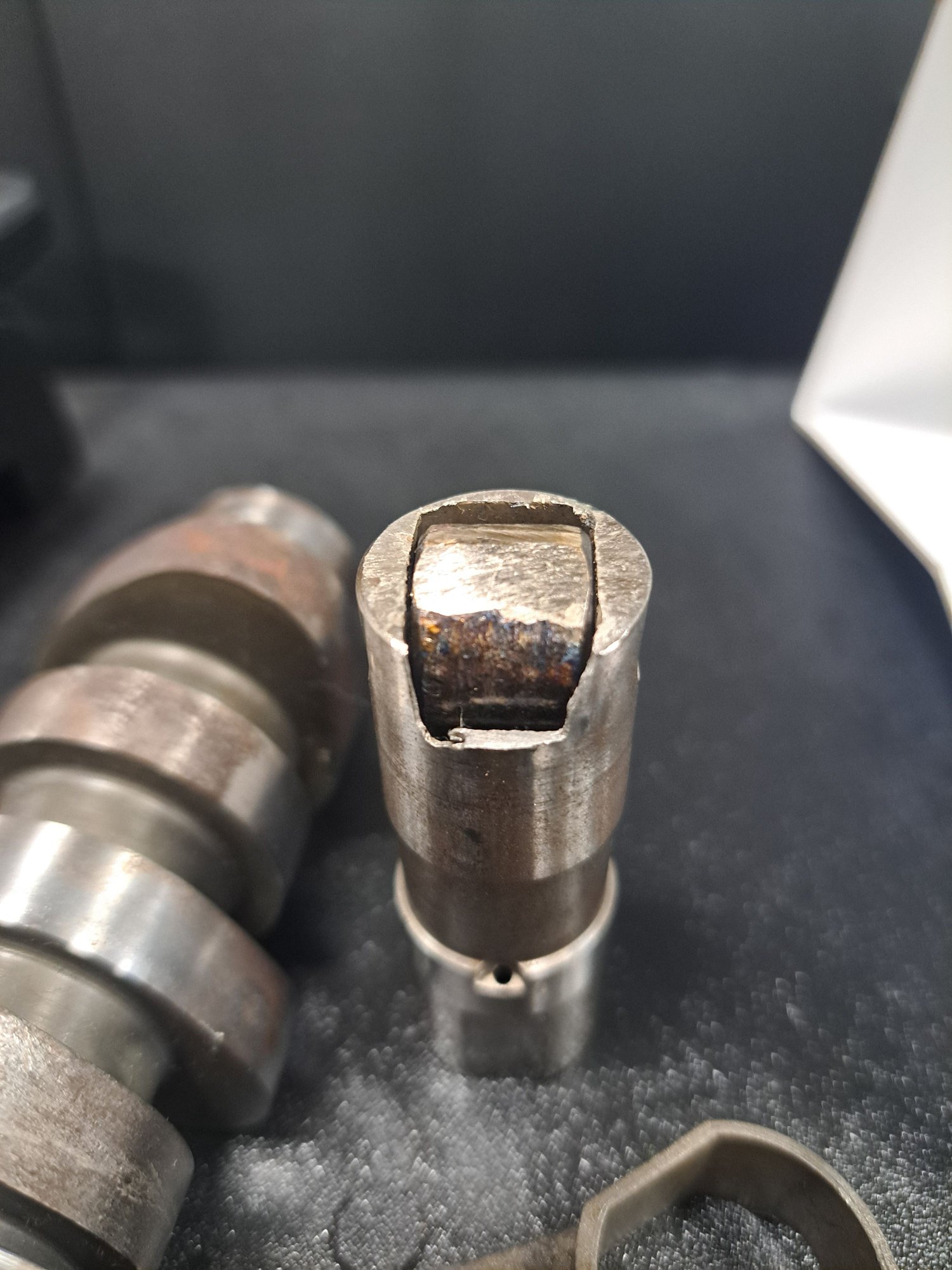

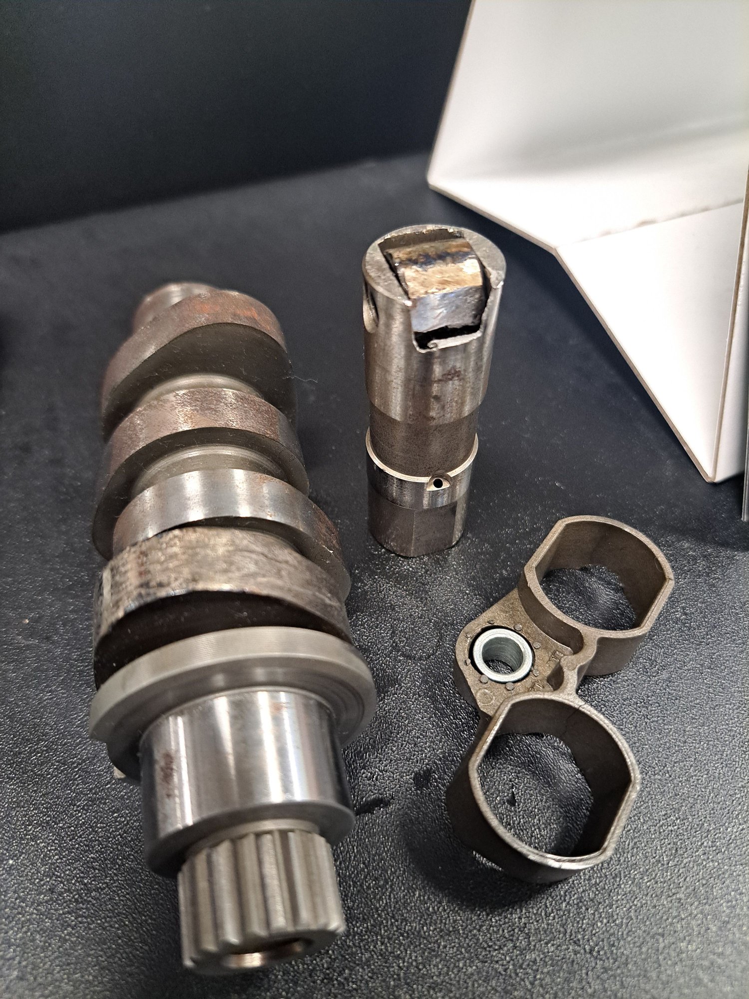

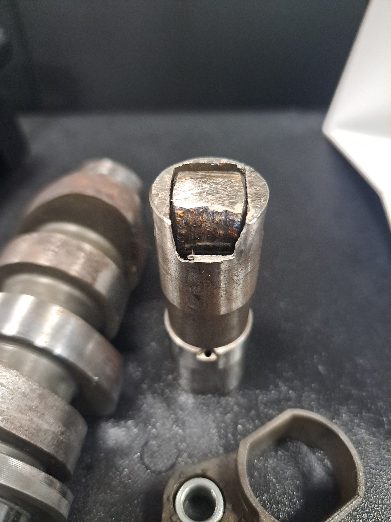

Howdy,
Many owners just buy and ride. Some start tinkering with stuff. And when stuff breaks, is it because stuff was messed with? Most likely.
If you leave EVERYTHING alone...some M8 motors go 100K miles with no issues.
Back story: at 5K miles a HD447 cam was installed. Original plastic cuffs reinstalled. SAVE money
at 20K miles the lifter cuff cracked on 2 sides, allowed the lifter to rotate 90° and DESTROY the entire engine. Metal shavings pumped into the entire engine. Customer rode the bike in for service.
IMHO, If you are that far into the cam chest kit, replace the cuffs. For less than $100 replace to avoid replacing the entire engine.
BTW, NOT my bike. My buddy at service dealer has it on display.
The cuff cracked on both sides

Hate to tell you but as others have said, that was a lifter failure first, and continued running engine with a failing lifter broke the Cuff, not the other way around. Your buddy got sold a bill of goods.

That is definitely a failed lifter, first, then it went sideways and took out the guide.
The HD lifters are somewhat notorious around here for having the roller pin fail, which of course leads to the roller failing next.
