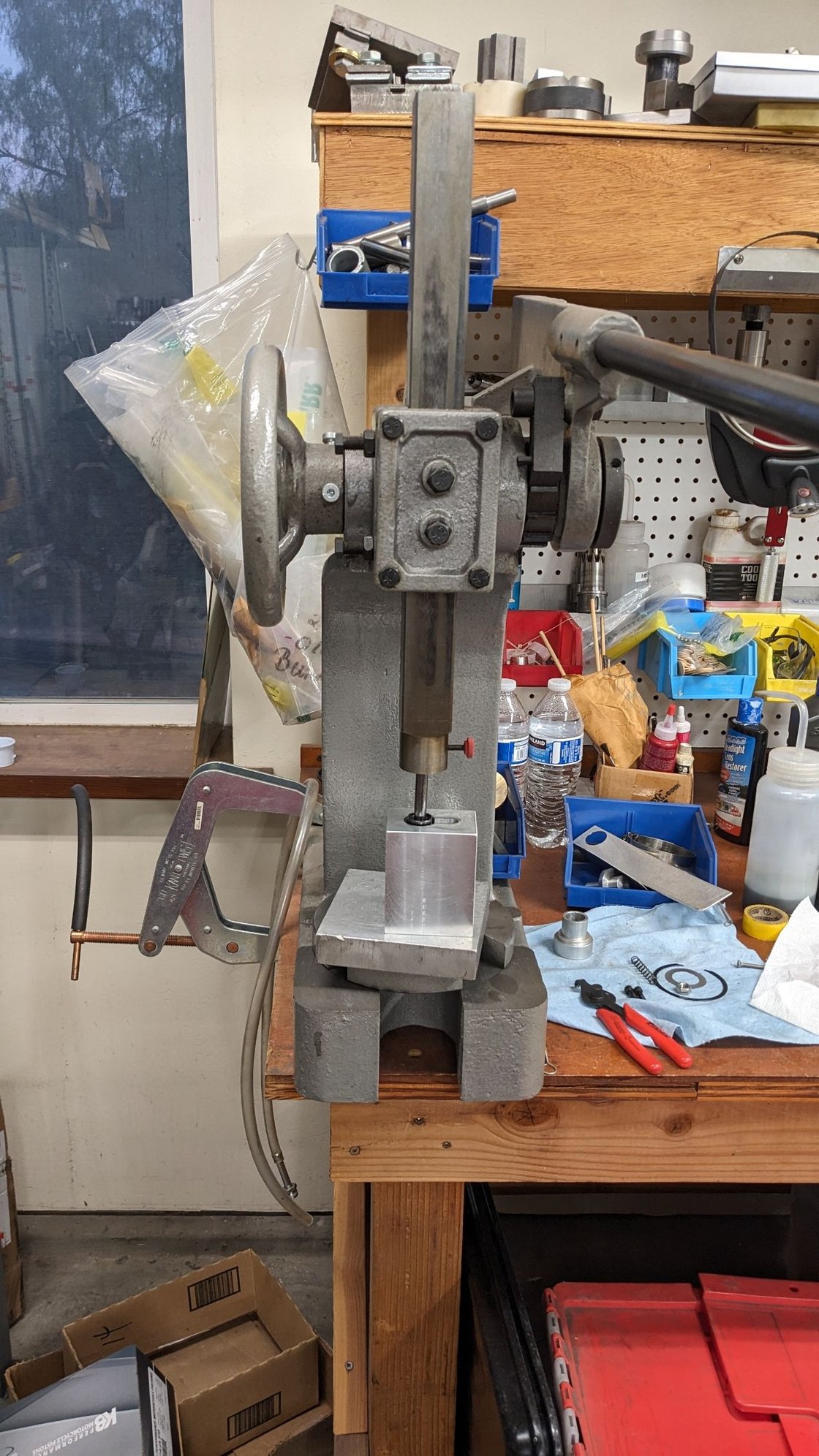

Replaced the current Johnson Hylifts with new Hylifts that have the pin oiler. Used a vacuum pump to purge air. Tested the lifters. Installed. One thing I did because I hated fiddling with the lower O ring was to roll it over the ridge at the bottom of the pushrod. Original lifter cuffs were fine.
