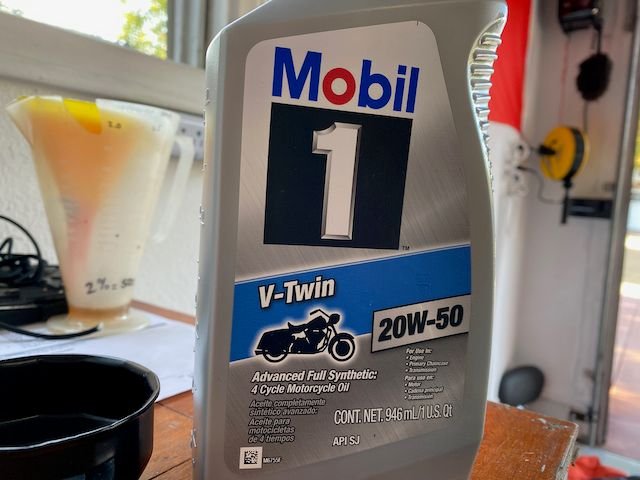

I recently changed the oil on my 2019 Street Glide Special...I used the following oil in all three holes; engine, transmission, and clutch. It's okay...
