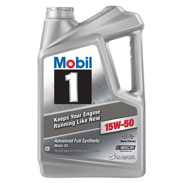

Best deal out there! And GREAT stuff! $22.88 for 5 qts. at Walmart.....
