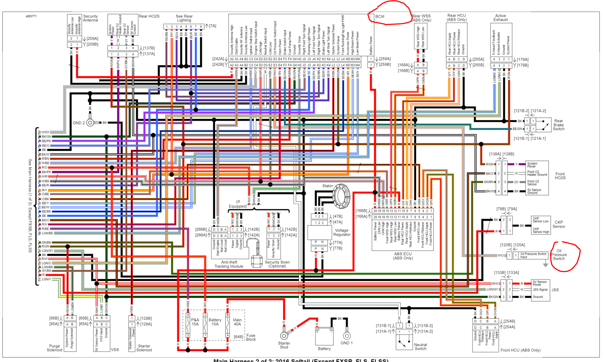

Now my theory is that either Oil Pressure Switch or its wire is faulty. After researching the wiring diagram, it looks like the Oil icon turns on when the oil pressure becomes low and the wire effectively gets grounded thus enabling the circuit. Here is what I am planning to try:
1. Disconnect the wire from the Oil Pressure switch and run the bike. If the problem is gone, then the issue must be within the Oil Pressure Switch. Need to be replaced. Otherwise, proceed with the step 2.
2. Disconnect wire from BCM module connection. If the problem is gone, then the issue is with the wire between the Switch and BCM. Wire needs to be replaced.
So my question is - if I run the bike with the Oil Pressure Switch wire disconnected for a short period of time, can it cause any issue?

i don't think you'll get anywhere by disconnecting the wire, in fact it may cause it not to run at all, i'd think you'd have to bypass it....but I wouldn't do that either....are you able to get to the wire that outgoing wire on the part your doubting and put a multimeter to it?

On the Sensor side it is blocked by V&H pipe. Maybe on the BCM unit side I could.
However the challenge is that the Oil Light blink happens for a fraction of a second while hardly accelerating. So to detect grounding I would need some sort of recording device.
Could you please clarify how to bypass it?

we do it to cheat or fool appliances that have safety switches....not permanently...just to isolate a part for diagnostic purposes....in your case, if you permanently bypass a switch, you could be bypassing the one thing that is preventing catastrophic failure in your engine....don't bypass anything on your bike permanently
lets say we got a flame prover.....or a snap disc...(i know not a motorcycle, different industry, but all electricity works the same).one wire comes in one side and exits the other.....if we suspect the part is bad, we'll put alligator clips on both wires and close the circuit....if it didn't run before, and the bypass causes it to kick on, we know it's a bad part and replace it....if it still doesn't work, the part is good and you have to look elsewhere for a failure
the better way though is to use a multimeter and know what the readings should be...or have an idea..couple probes in the right place will tell you if you have juice going into that switch and juice coming out
