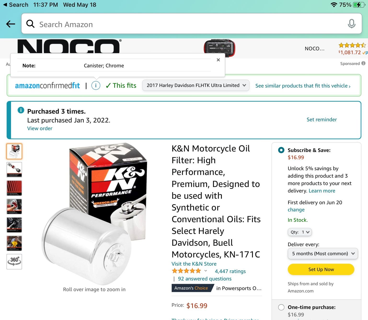

FWIW…I tried the K&N a few times. But, since I went to the dealer for Amsoil…I just went over to the Hd filters agsin. And the K&N are getting expensive too.
