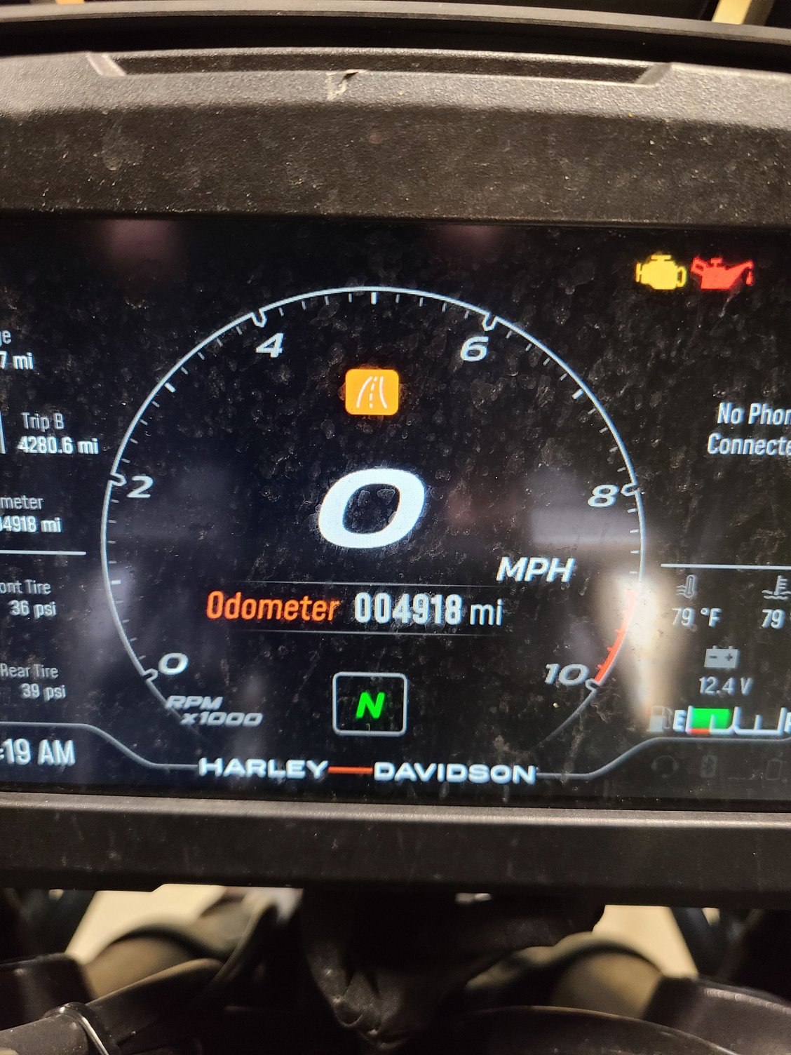

No issues the rest of the way to Sheridan, WY via SD and nothing until after we left Sunday. We got to Colorado and the rain hit harder so I put it in Rain mode to get to just south of Ft Collins for the night. The next morning I switched back to Road mode while moving and I got a Triangle caution symbol. We stopped and I restarted and it went away. Rest of the trip home was uneventful mechanically, weather was another story... at least the rain in Texas wasn't cold, good thing cause we got soaked! The kind of rain that rain gear doesn't help lol

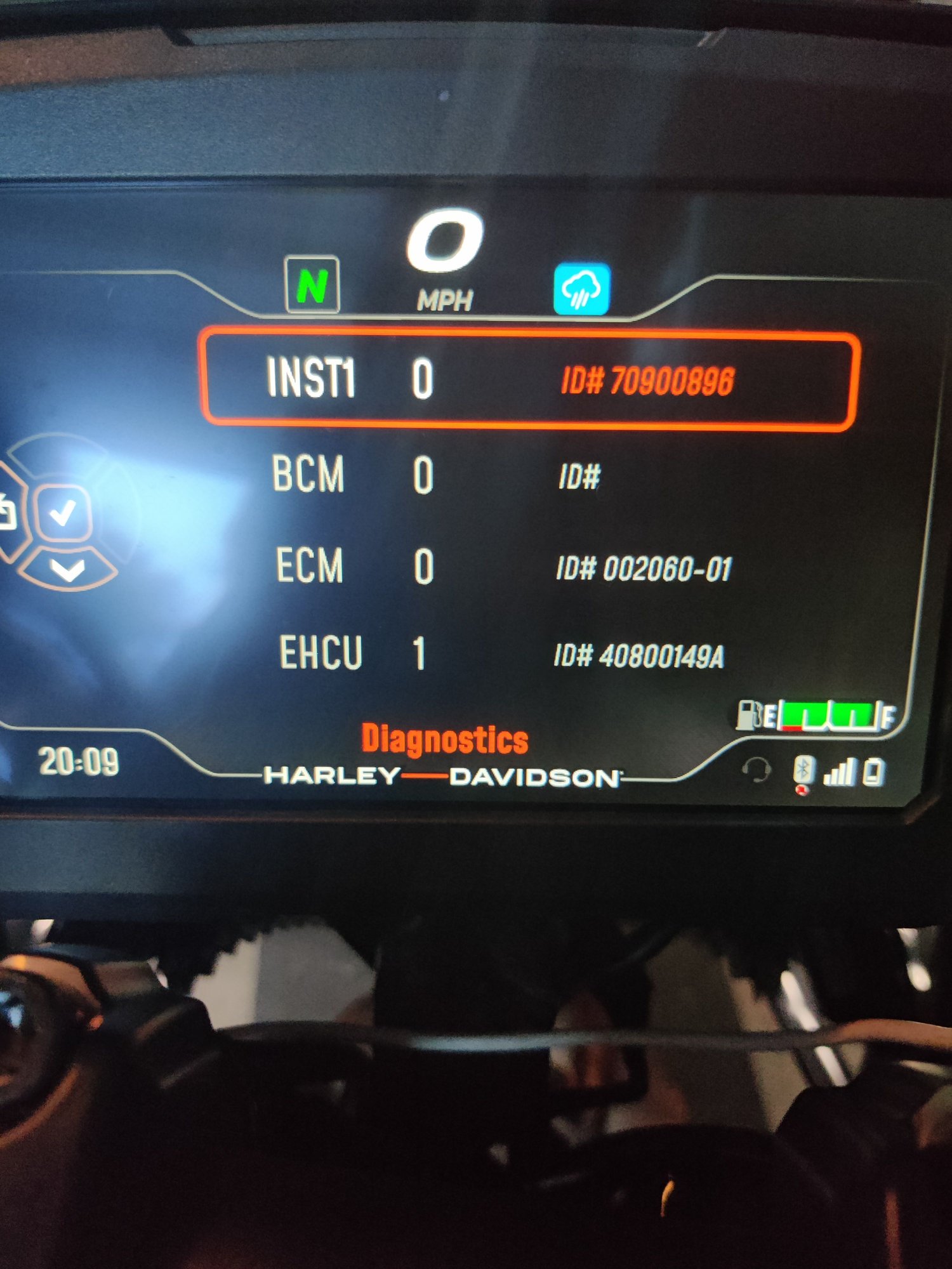

Out of curiosity what were the codes that were thrown.
I have 300 miles on mine and it just shut off while riding when I checked the diagnostics screen I have the following
When I scrolled EHCU and selected it it showed
I checked the dip stick for oil and that was ok.
I let the bike sit for a few and decided to start it no check engine light no oil light no odd sounds . Limped it the 10 miles home. Will have it at the dealership first thing for them to check it out.
I can't find the code it threw on the web does anyone know what it means?
