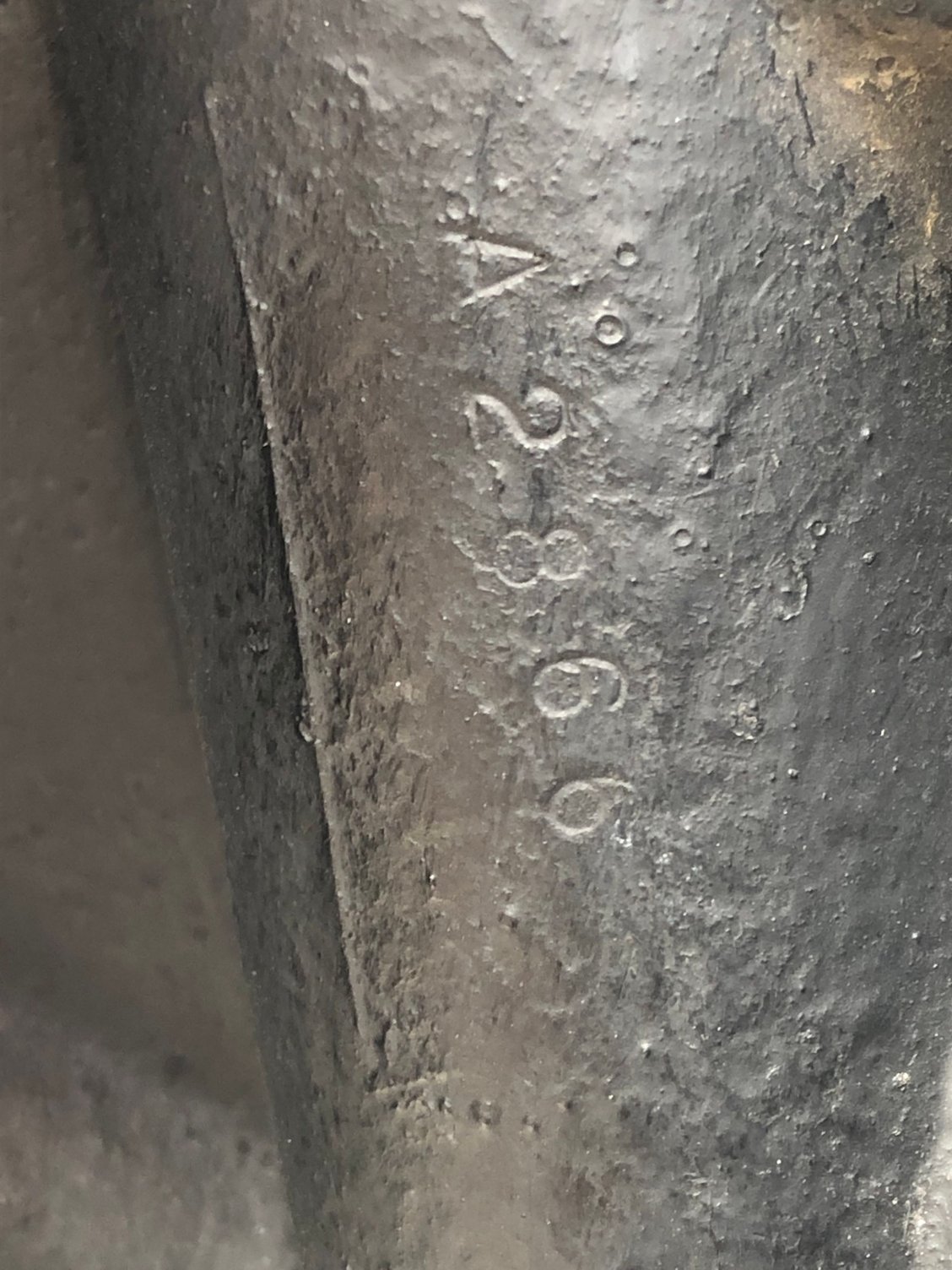

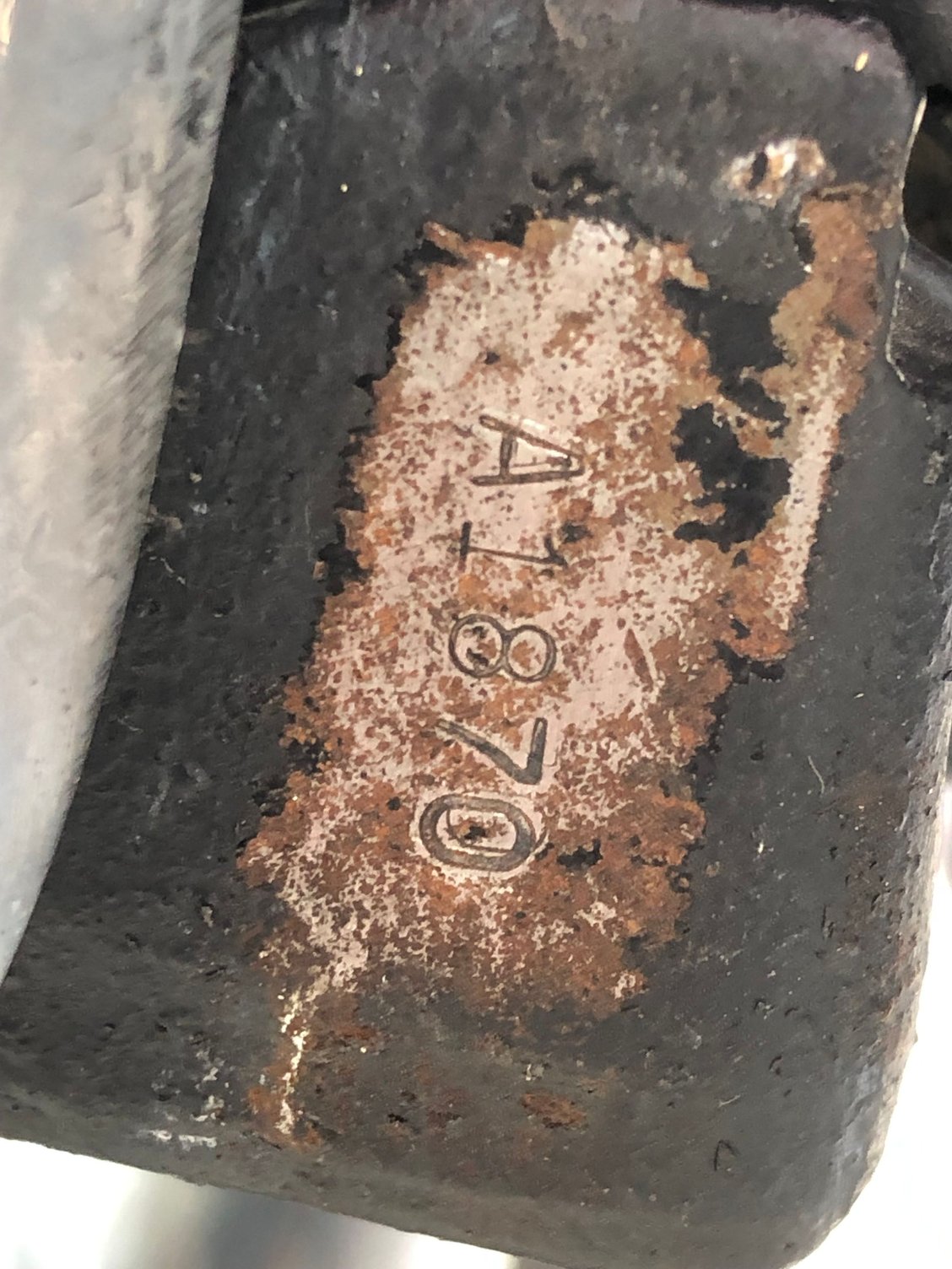

Anti theft numbers on gearbox, lower tree then left side of neck.

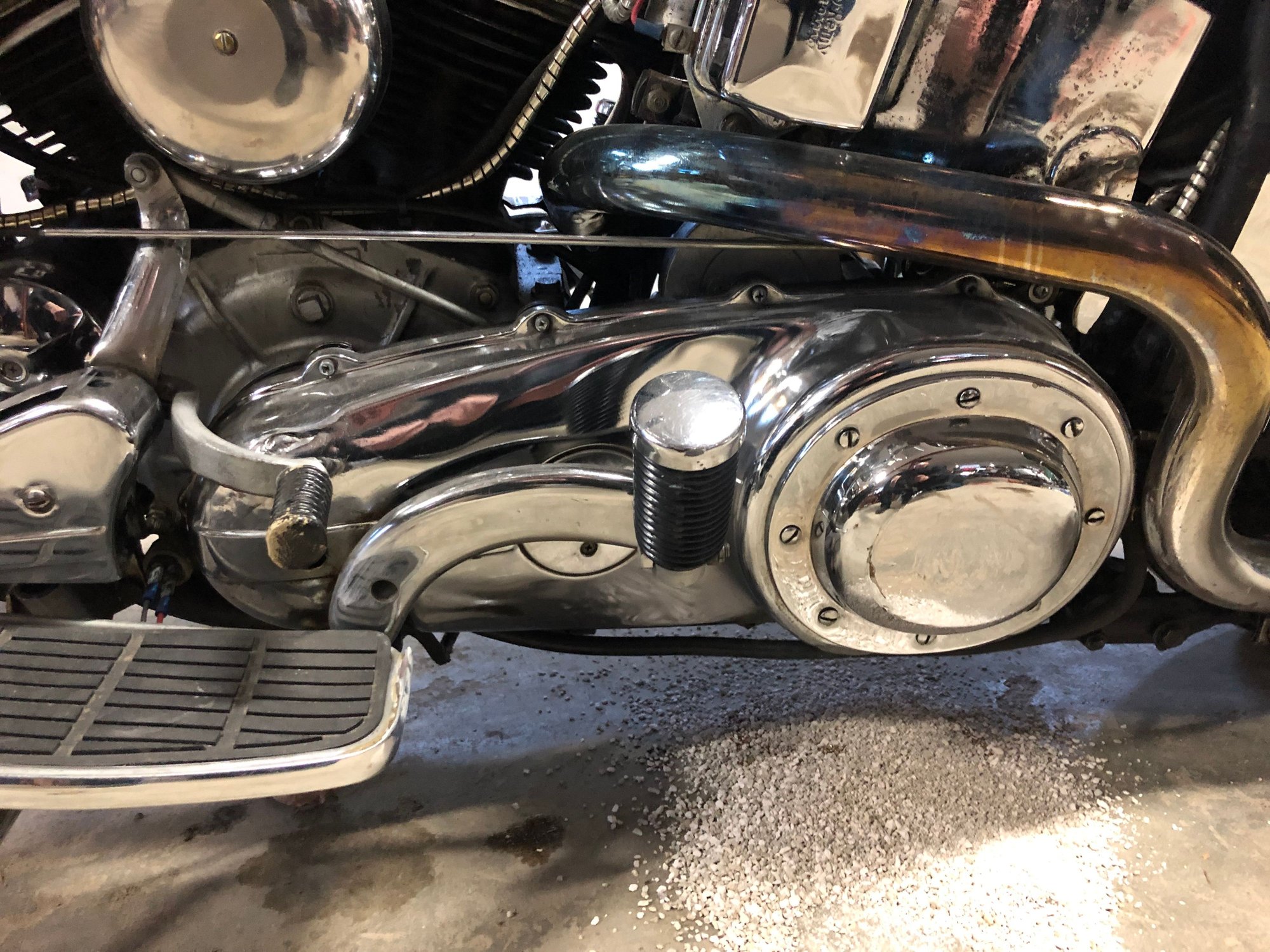

So the chrome primary should be black and no crunch mark near the shifter. Buddy seat came with it plus an extra front brake drum, a windshield and some other minor odds and ends. Spot lights are wrong. Headlight high, low and off switch is on the left bar. Right bar has 3 holes for an additional switch like my 66 where the starter button would be so I assumed the bars had been changed.

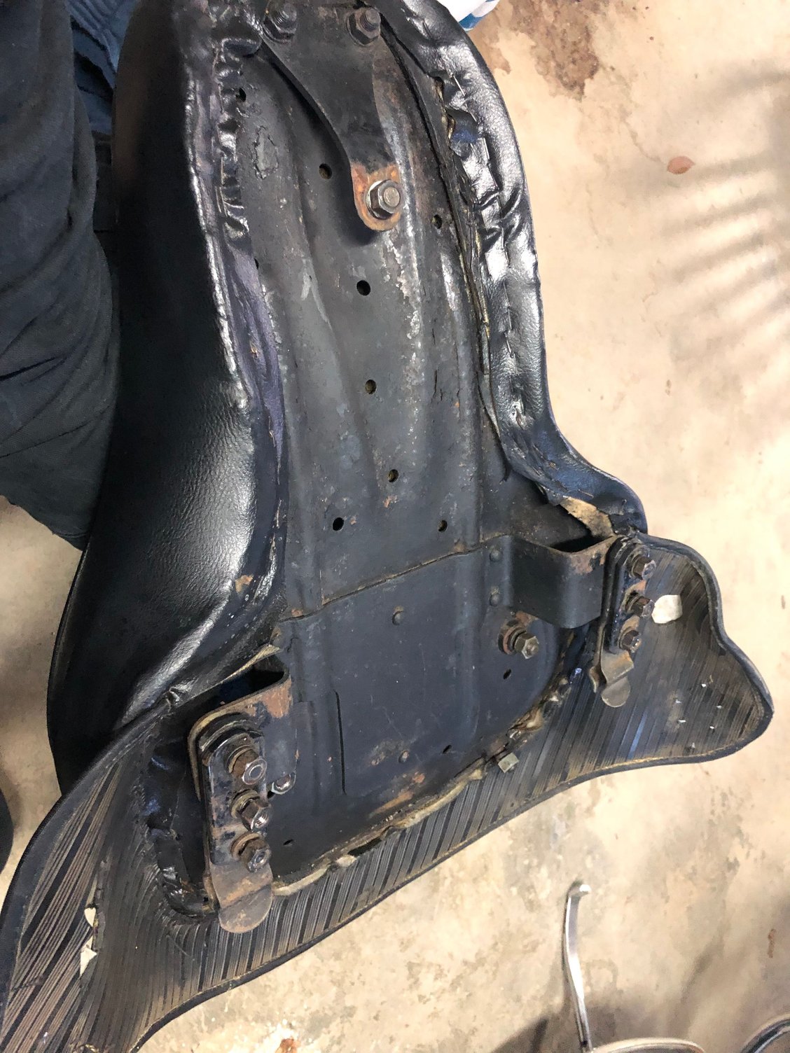

Buddy seat came with the helper spring and hook that holds it to the fender if its not needed.

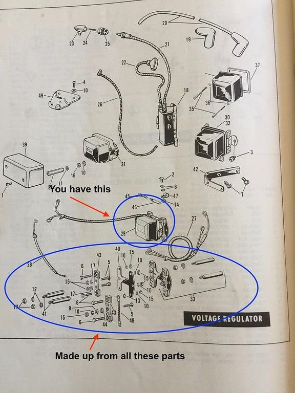

What puzzled me the most is how elaborate the regulator mount is. Is any of that mount factory?

Have to say I've never seen a voltage regulator mount like that.

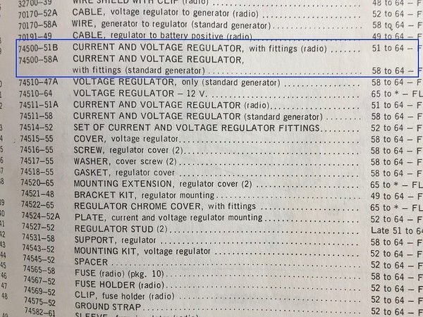

However.......after looking at my factory parts manual (1958 to 1968) what you have is a factory part #74500-58A Current and Voltage Regulator w/ fittings (standard generator - 58-64).
There is another part number for those listed as used with radio modles. Don't know the difference though. Don't know why this style in lieu of the standard type seen on most pre-65 Pans.
I've only seen the standard Bosh generator with the right side mount until you posted yours. Definitely a bit unique and worth running it (my opinion only just cuz I think it funky but cool). Think I have and OEM black painted cover. I'll try and dig it out for you so you can get rid of the chrome one if you want.

Ill have to look in my book but ive found the 61-71 book I have doesn’t show everything. I saw a book that goes from 58-68 listing Duo glide on the cover so I’ll have to get one of those.
The regulator mount did look like something OEM, definitely not home made. I would like to figure that out.
