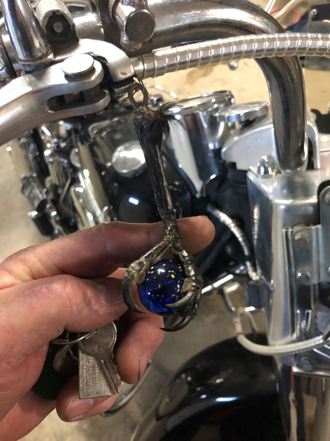

Chicken foot was an option.
Ok...yu got me. 1st time I've seen something like that.
