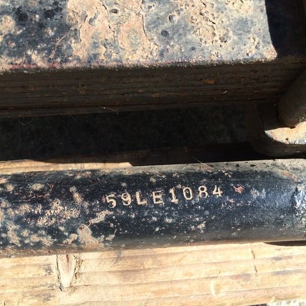

Not a problem at all...
and look something like this. Starts with the year of the frame. On mine it is 59 (1959). 1084 means (I think it means) it was the 84th sidecar produced for that year. Not sure if the VIN on the bike would have matched the serial number on the sidecar frame. I know that for 1959 FL models started with a VIN of 1001 and ended with 6750; FLH models started with a VIN of 1002 and ended with a VIN of 6753 so I would think it is possible.
Does your sidecar body have an oval tag screwed to it under the leading edge of the seat?

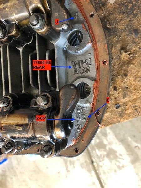

Couple of pics of the heads before taking them back to Aberdeen SD.
Front....casting date code had to have been ground done because it interfered with the rocker cover. Not sure what the letter "E" means (nothing in palmer's about it). Palmers states that the "K" is located aboved the casting nubers but there is no explanation of what it means
Rear... casting sate code is legible and also has the "E". Palmers states the letter "J" is above the casting numbers but again there is no explanation of what it means

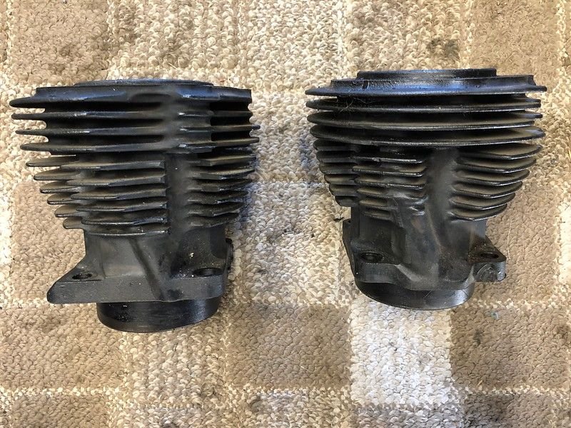

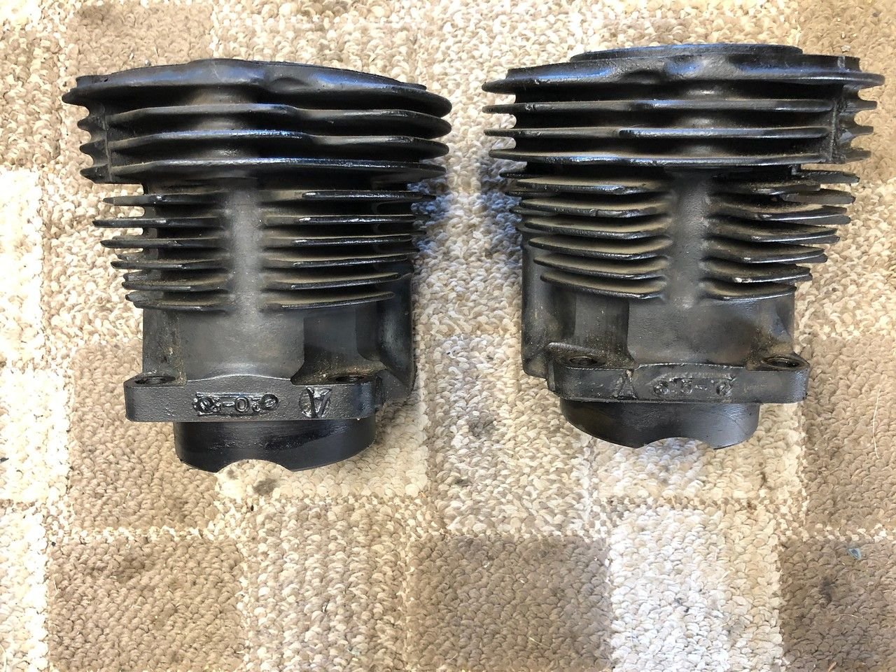

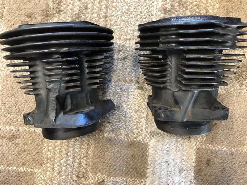

Couple of the "before" cylinders

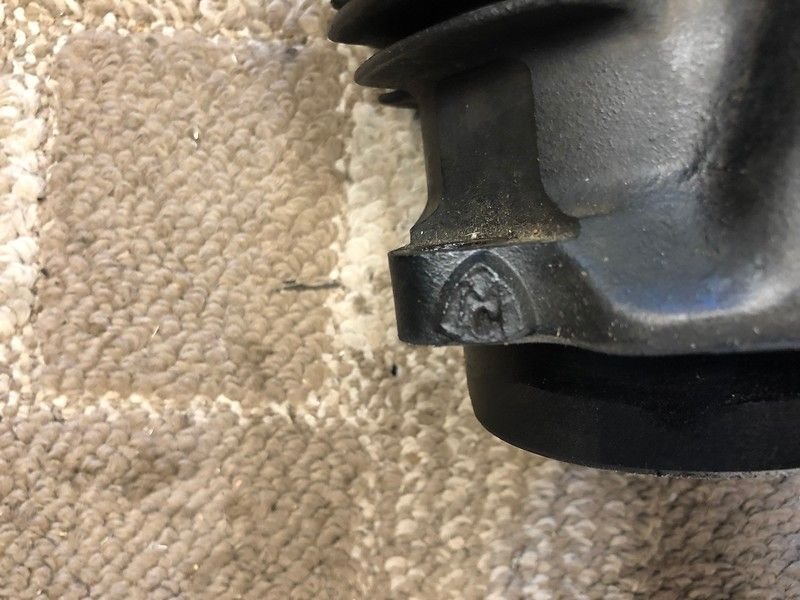

Unfortunately iu did not scrape off the paint before going east in order to get a good read on the cylinder date codes. And the assmebled motor is no help either. Definitely a mistake on my part. I believe the forging casting stands for "Motor Casting Company" (MCC).
I don’t know what the E represents but it’s on a lot of heads for Pans. Not all but a lot. The earliest I’ve seen it is on a 1948-49 rear head with casting number 119 482.
I don’t know what the K and J mean but I’d like to see Palmer’s evidence about them being part of the casting numbers. In his 37-64 SE he said 63-65 front heads have casting number 16700-56 K with the K located where yours is. But how did Palmer conclude K was part of the casting number?
For 63-65 rear heads Palmer included J in the casting number (16701-56 J) but now the letter is even further away. How did he conclude J was part of the casting number? And if he thinks J is part of that casting number then what about the letter D in that same position on the Jan 61 rear head below?
I’ve also seen D in that position on 16701-56 rear heads cast in May 61 and Nov 60.
MCC logo was used on Pan cylinders from about mid-63 (model year) thru 65.
Front cylinder looks like it has the letter A indicating January. It’s the right way up and at this stage that appears to be normal practice for letters on Pan front cylinders regardless of casting month. Exceptions? I haven’t seen any yet but it’s possible.
Front plate is small. It seems they were large for a long time but changed to small at some point during the 62 calendar year. I imagine the plate is the right way up? If so, that appears to be normal for plates on most Pan front cylinders but I’ve seen a 1957 plate which was upside down. Hard to read your plate but there may be two characters in the day portion?
Rear cylinder has its letter (A?) upside down and that appears to be normal practice for letters on most Pan rear cylinders. But in 52, 53 and 54 some letters were upside down while others were the right way up.
At least three sizes of plate were used for Pan rear cylinders. Yours is small and obviously upside down as most were although sometimes it was the right way up. Day portion looks like 20 but it’s hard to be sure about the year.
