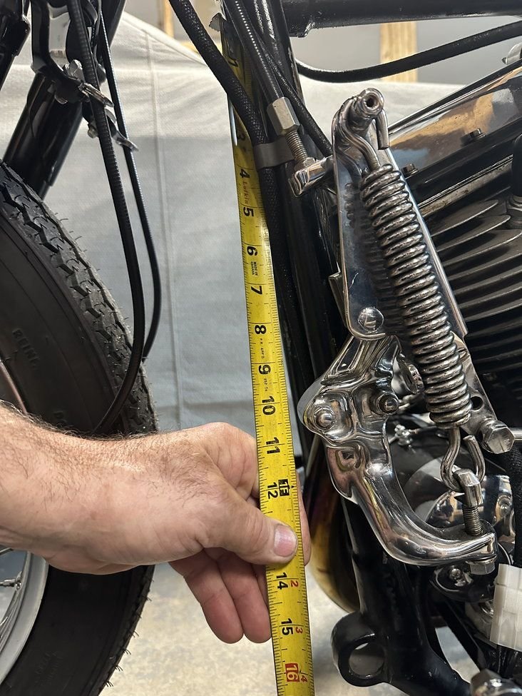

There is a spec for it, here's where it goes.

The pic I posted, I measured from the bottom edge of the tooth for the steering damper to engage into and the middle of the u-bolt.
