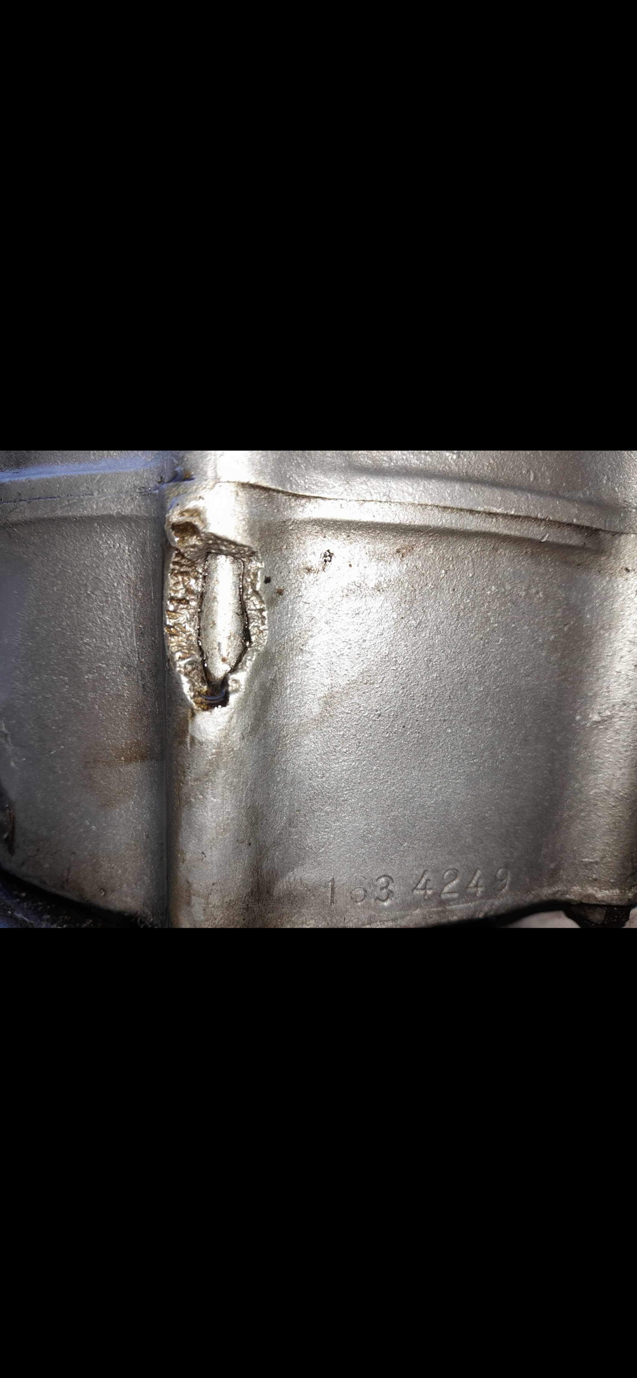

Old Dec 22, 2023 | 05:04 PM
FX Man's Avatar
FX Man
Joined: Jan 2022
Posts: 99
Likes: 19
From: Melbourne
Originally Posted by hellonewman
I wouldn't worry about paint. I would check the belly numbers and the other casting dates.
So the plot thickens, the frame had an engine guard, this is what was under it when removed.. Makes me think that silver paint may actually be hiding some sins!!!!
Old Dec 22, 2023 | 05:11 PM
QC's Avatar
QC
Joined: Mar 2012
Posts: 100,455
Likes: 19,811
From: Centennial, CO
Is that a crack emanating from the blacked number to the case bolt???
