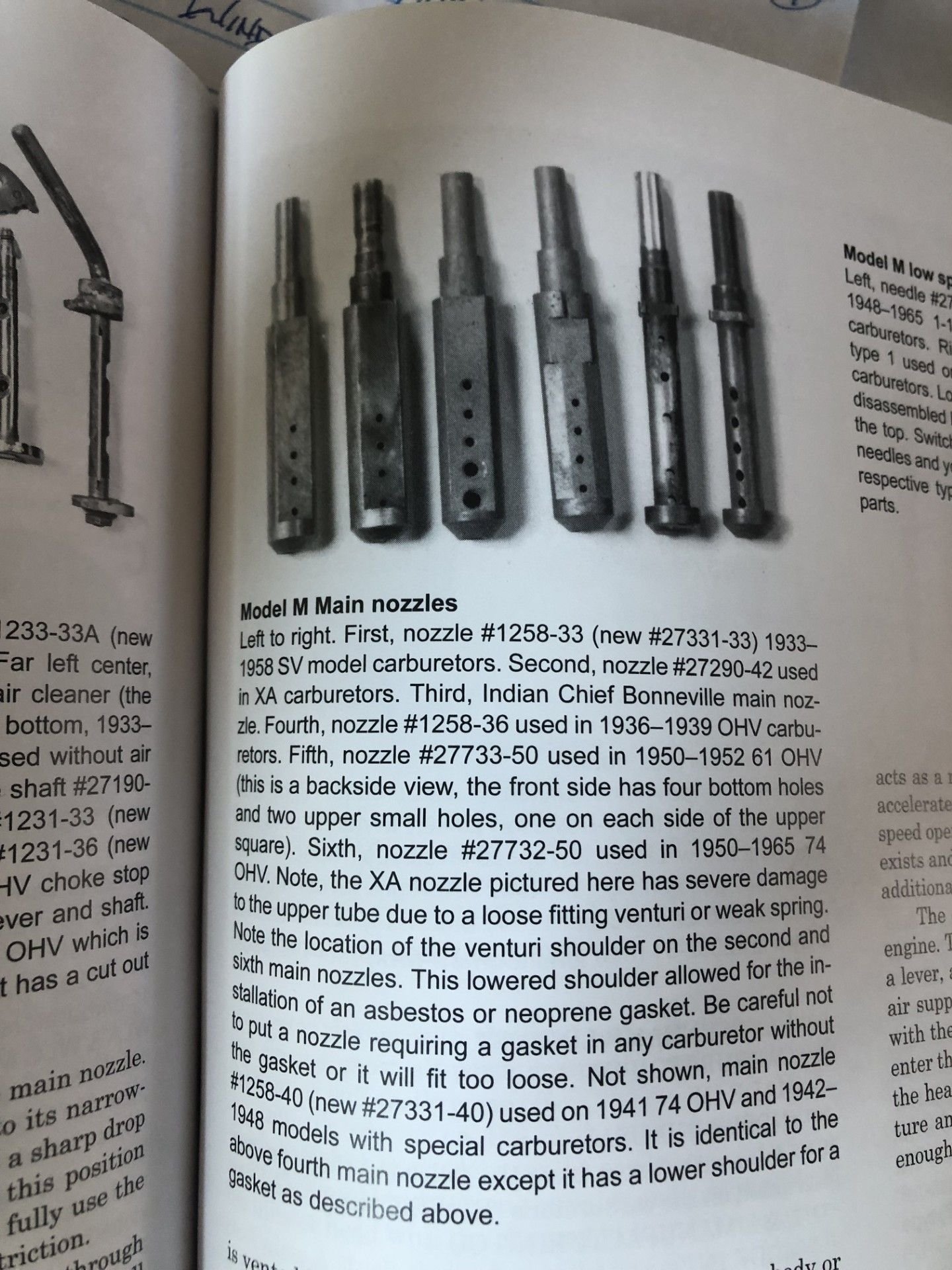

So I'm digging though a bunch of carb parts and found that I have 2 emulsion tubes for the Pan carb. Which one is the best?

Seen it and forgot i dont believe you have the correct one for a 74B carb i believe its 5 holes and the 2 bottom are larger but i will try to remember tomorrow

Pretty sure Palmer talks about the tubes and which one is for which carb, give it a look in the Book.
I was put on a waiting list for the 3rd edition over a year ago.. I guess I'll have to buy a used one off of fleebay. Some of them are pretty pricey..

This should help:

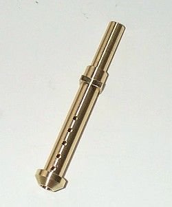

This is the correct for your M74 or 74B

Thanks for the info guys.. The carb has the correct emulsion tube in it..

The holes face to the throttle blade - the bikes G force is so great compared to a Twinkie it needs the extra flow that gives it as its a real mans bike
Wouldn't it be better to have the holes face face forward? Under acceleration you get more fuel?

As i understand it - at the rear the Venturi sip has the greatest amount of vacuum on the nozzle
race guys usually find the real deal in what actually works - its in the linkers race book
