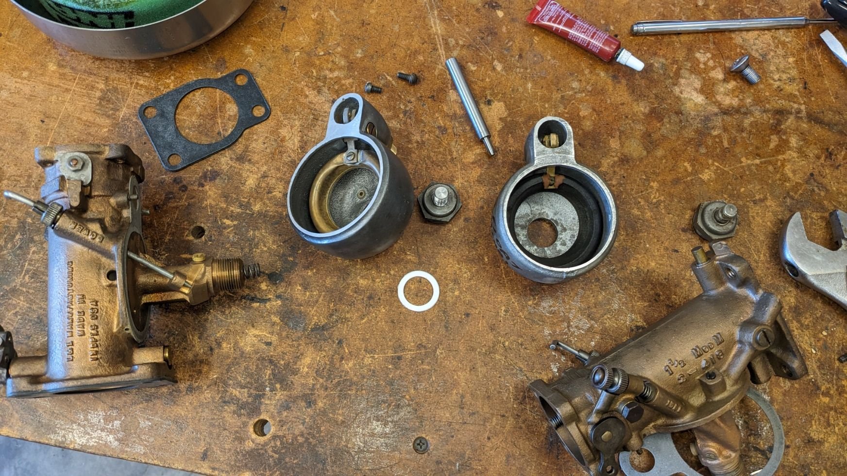

I have not been riding the my 65 of late because the last 3 times I rolled it out, it would start right up then while idling it would die and not start again. First time it was low on gas so I figured that was the problem so just pushed it back into the garage and rode a different bike.
A week later I put a gallon in the tanks, and the bike started right up.. Go to get my gear and while warming up the bike dies and won't start. It goes back into the garage. I'm beginning to wonder something wrong with the petcock.. The pan has the stock fuel shutoff that I rebuilt with a valve needle point made out of Peek plastic. If I close the valve tightly is seals but the valve handle is small and it sticks when tryin g to open. I was thinking there was something wrong with it.
Pull the bike out again and try to start. Again it starts right up and runs for a minute or 2 then dies like out of gas. I pull the filter cap and turn on the fuel. Fuel rushes out. I push it onto the bike lifts and it sits while I work on another bike..

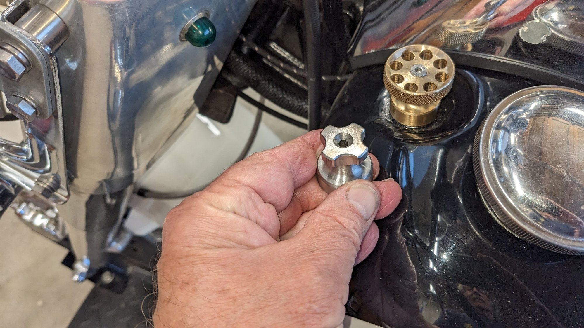

At this point I'm thinking carb but want to fix the fact that the fuel valve is sticky and hard to open.. I had made the first fuel **** out of stainless and found that I couldn't knurl it. The next one I made out of an old bronze boat shaft and was able to knurl.. (see pic). I want to do this just to make sure that the fuel valve was easier to control.
Next I pulled the carb. What a PITA. The loosening the throttle control wire was almost impossible with the 5 gallon tanks. I could not get a straight enough shot shot the slotted screw so ended up using a pair of small vice grips.. Get the carb loose and I can't move the car high enough to pop it out of the lower bracket. The throttle arm hits the bottom of the tank.. I finally manage to pry pop the carb bowl nut stud out of the lower bracket and get the carb off.
I pull the float bowl and find that the float had swollen just enough to stick in the bowl.. My guess is that I'd run the bike out of gas and while the bike sat the float would dry out enough to shrink and drop down. The next time I went to start the bike, the bowl would fill and float stick. This was the second carb that I had and the first I'd rebuilt and it had a coated cork type float. The one planed to use had a brass float but had an issue with the venturi leak so I simply swapped the carbs. Anyway I pulled the float bowl off the carb with the brass float and installed it.. I trimmed the bowl nut stud and added a socket head cap screw to the throttle arm so I could tighten it with a ball end allen..
Bike seems to be running fine. I'll ride it today..
