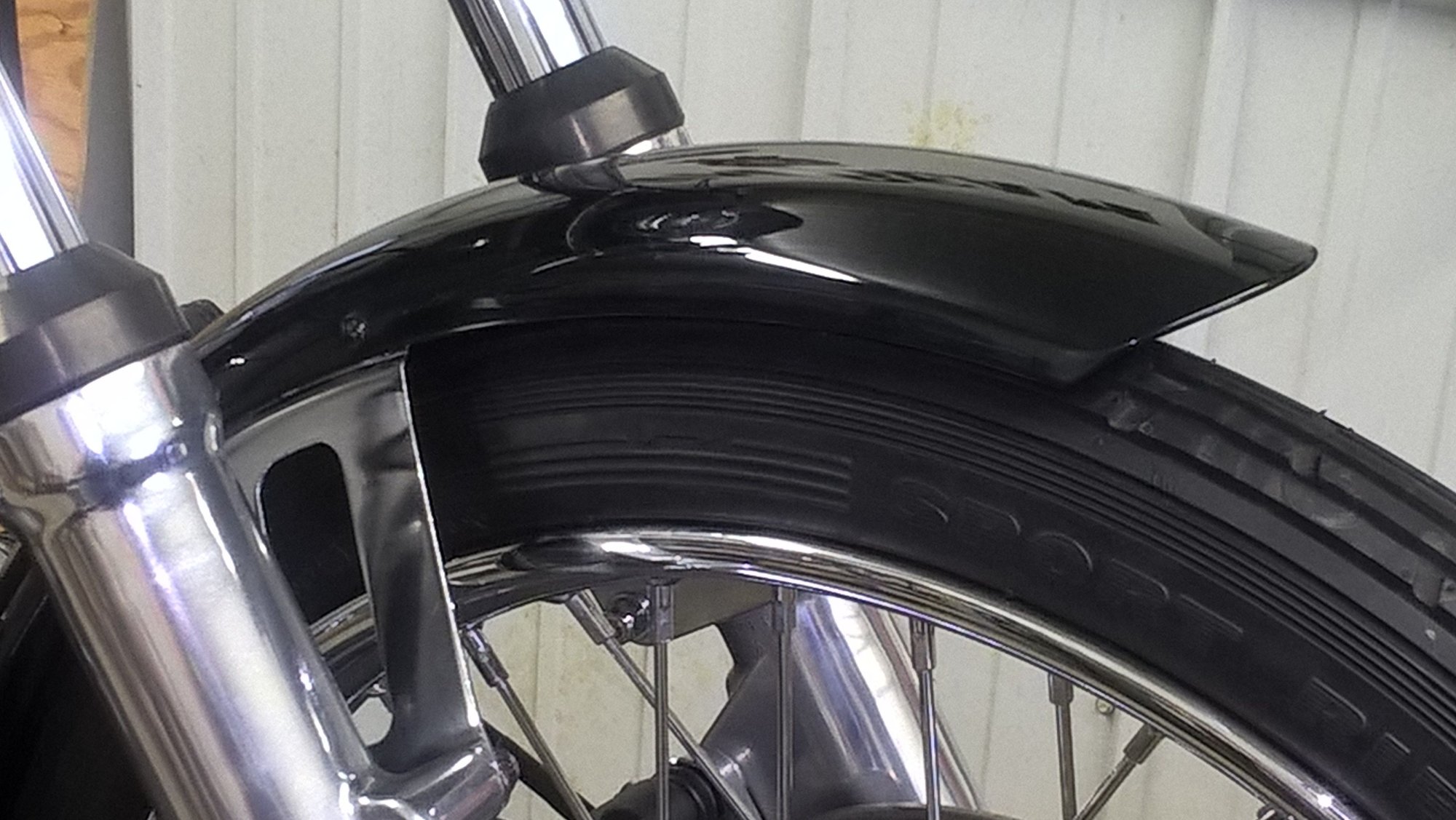

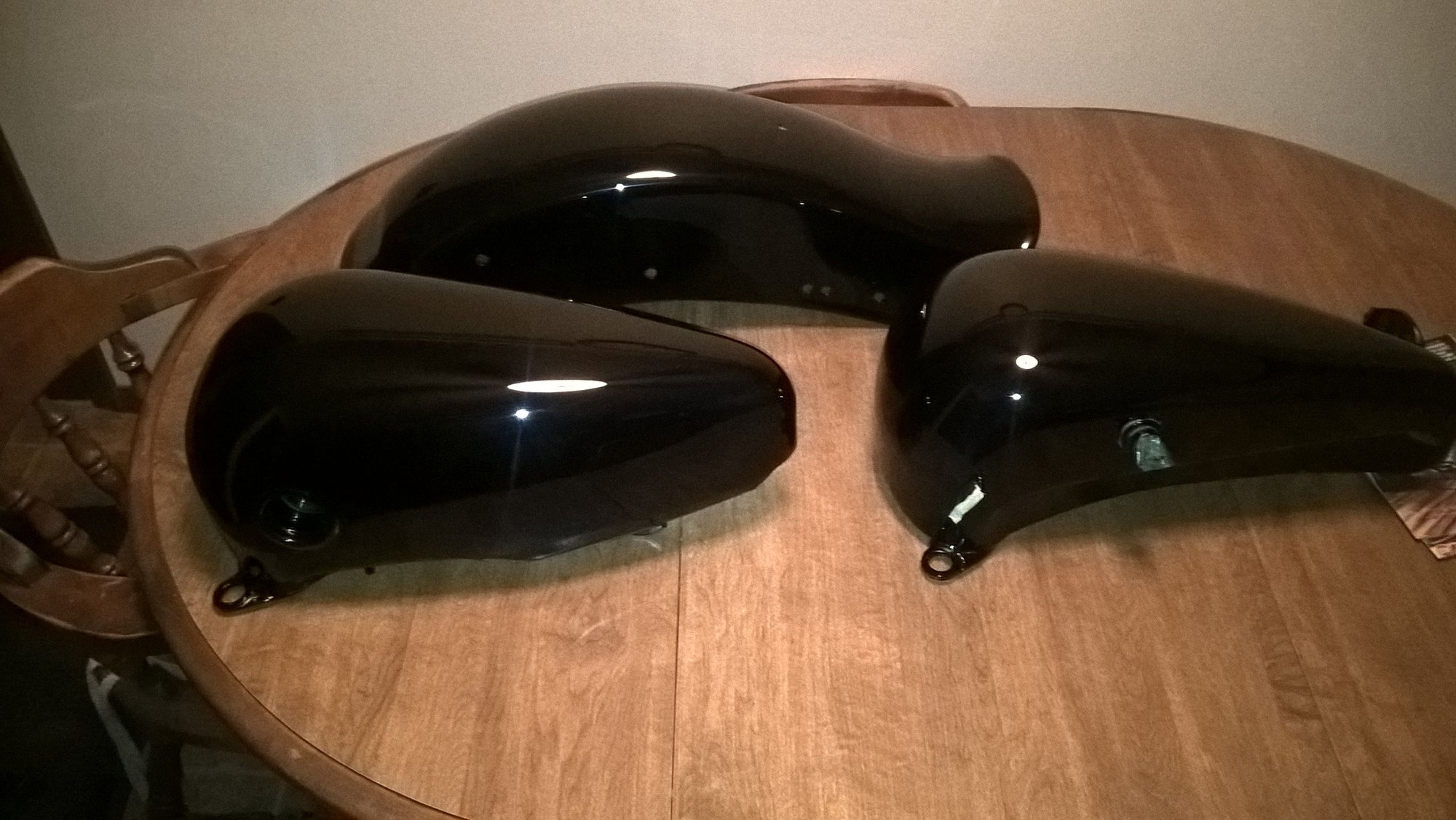

My powder coater always sandblasts chrome, or anything else for that matter. A smooth surface will not adhere the powder paint as well as a rough surface. The paint "melts" in the oven and smooths out for a good finish. The rough surfaces don't show afterward. I had the exhaust (chrome) hangar bracket powder coated, and it came out fine.
I had my tanks and fenders powder coated. The powder coater buffed them out and they look great! Powder coat paint can be polished just like regular paint. The more elbow grease you apply the better they look.
