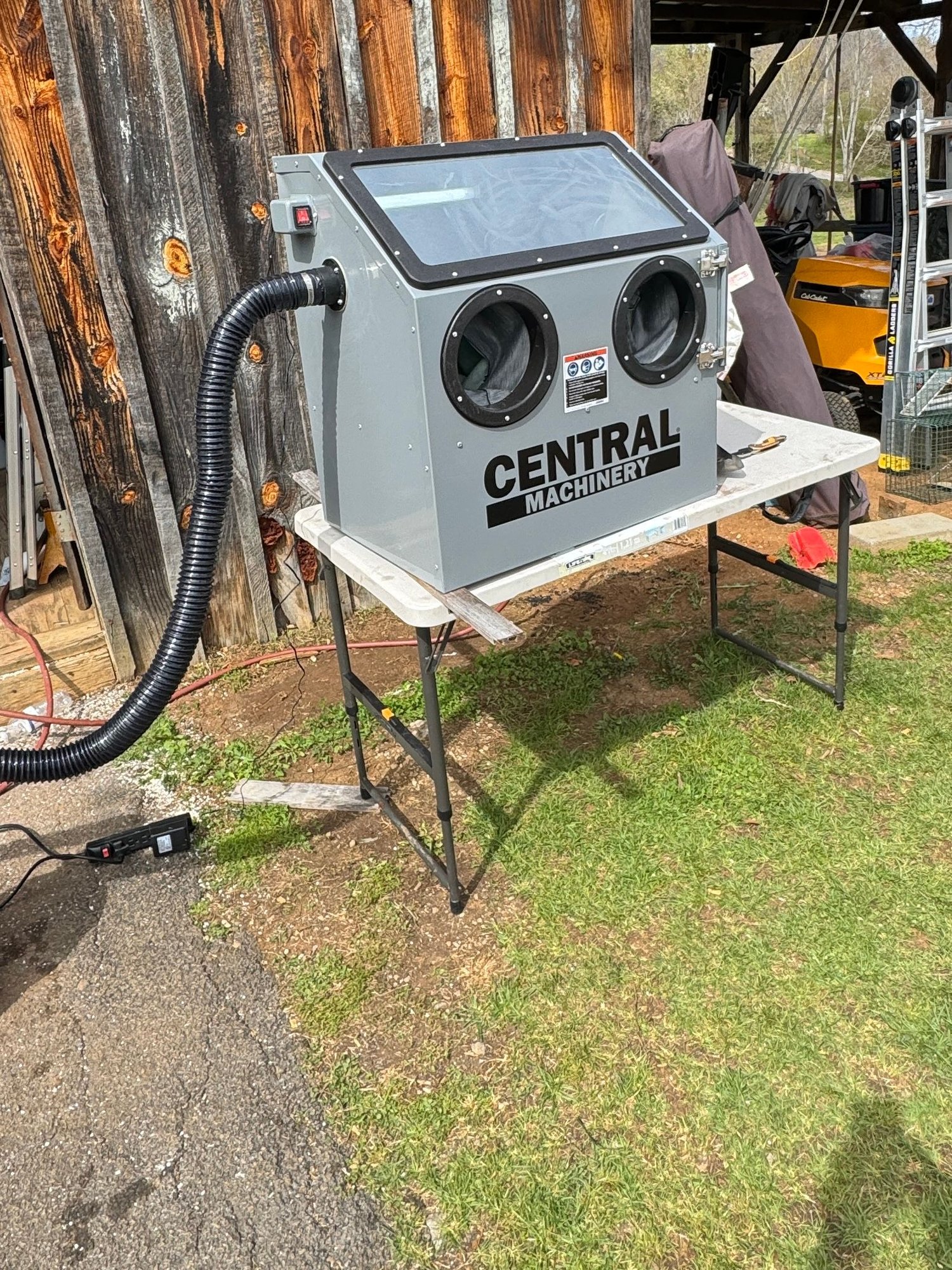

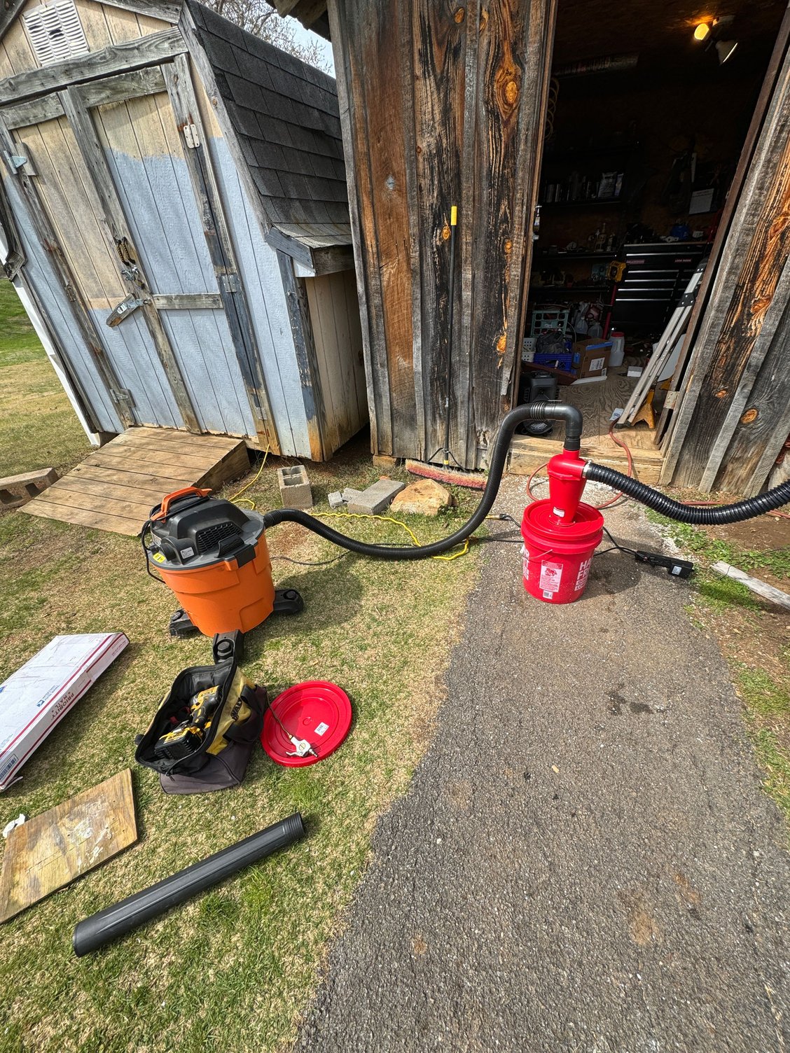

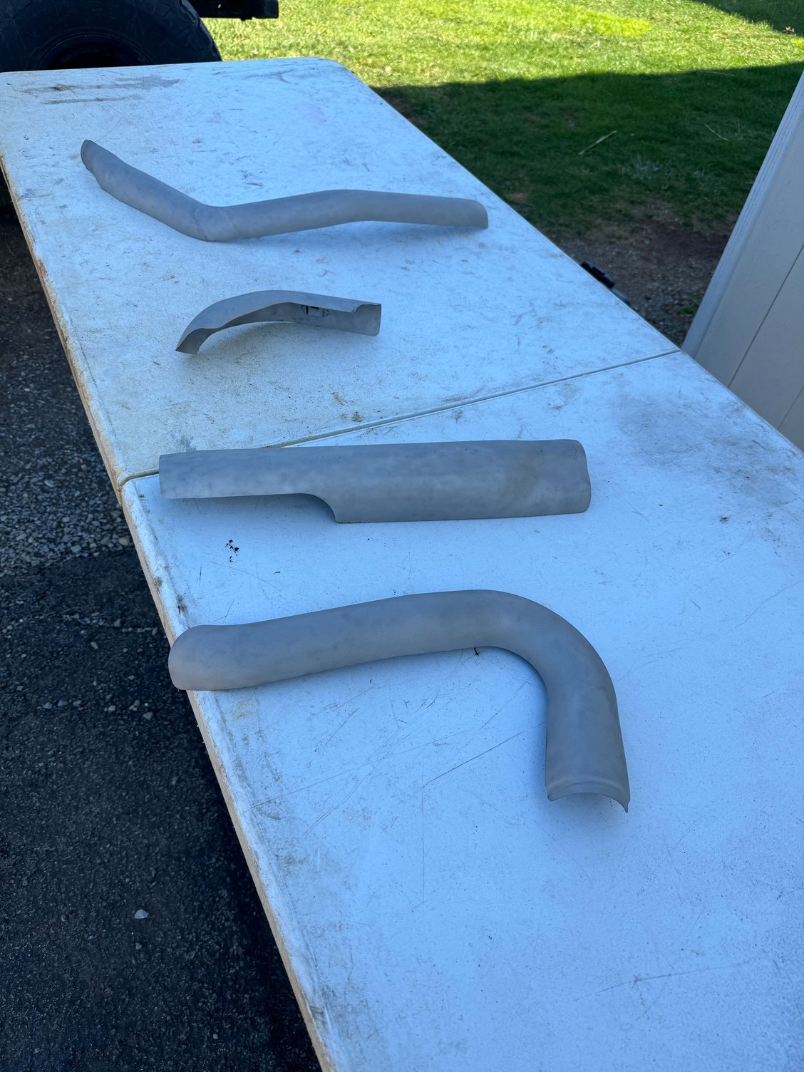

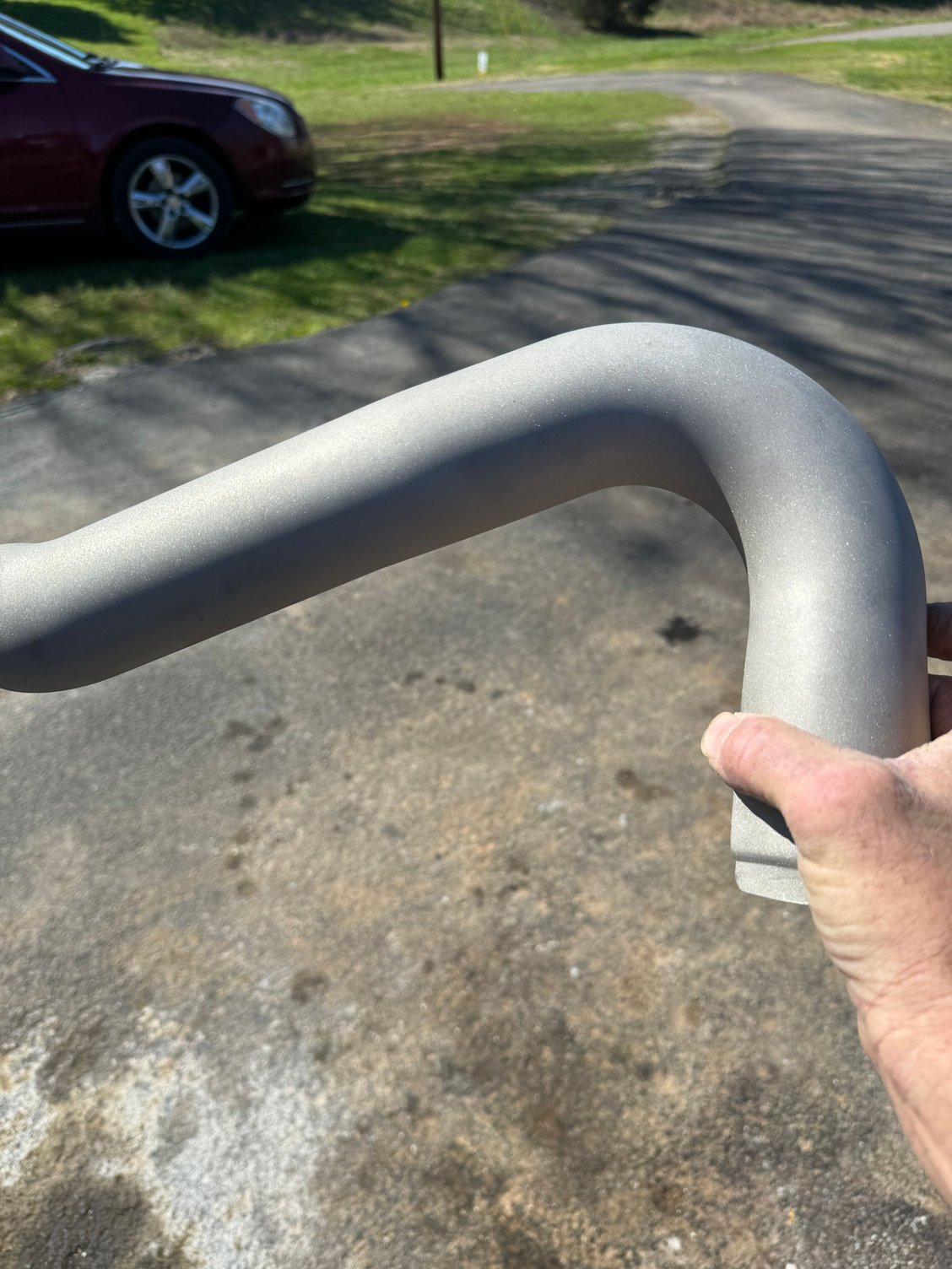

I actually went ahead and bought the Cerakote kit. I also went ahead and bought a blasting cabinet so I could prep the shields per Cerakote’s instructions. Yes, it would’ve been cheaper to pay someone else to do it lol, but I’m actually glad I invested in the cabinet because I’ve been wanting one for years. Anyway, I started sandblasting a couple weeks ago when I had time. I’m waiting for the weather to turn nice and stay that way before I try to paint them. I will update this thread when I’m done (or start a new one). In the meantime, a couple pics …
The little cyclone deal here works great, it really keeps the dust down !

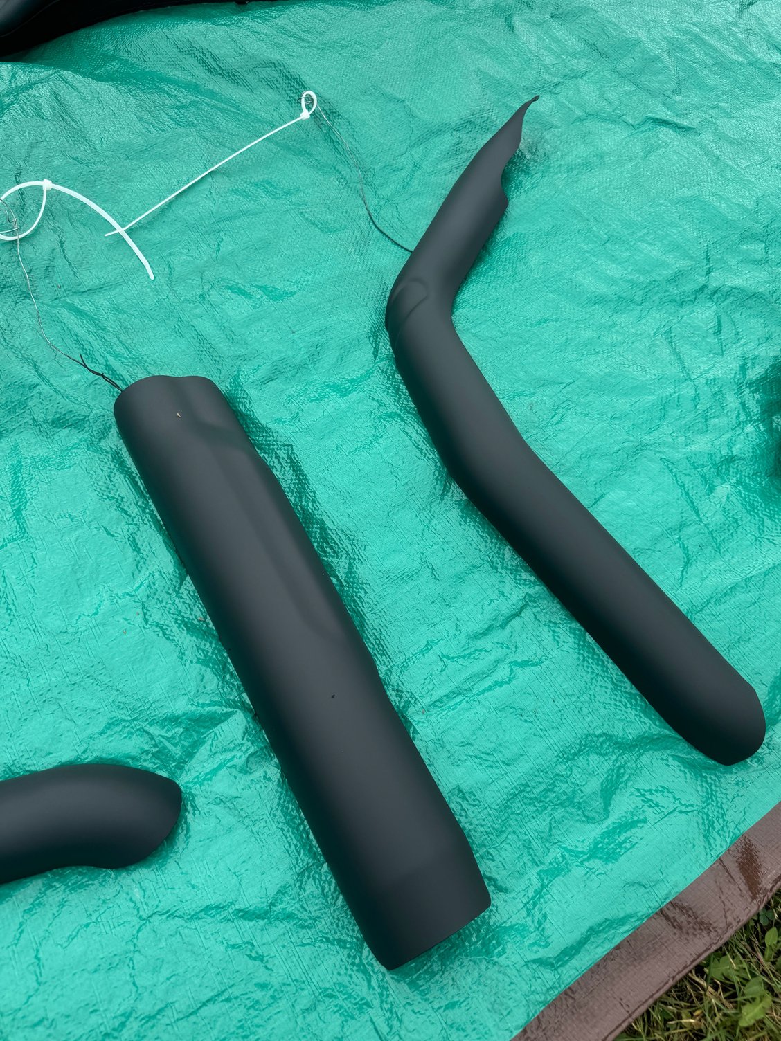

I know it’s been a minute, but I finally got my heat shields sprayed the other day. The conditions sucked, it was windy and hot as a **** and I couldn’t keep the bugs off. Oh well, one of these days I’ll have a garage…anyway, they didn’t come
out half bad, all things considered (I haven’t painted with a gun since my auto body class in high school). The paint is a little flatter than i was hoping for, I expected a bit more gloss to
it (it’s supposed to be a “satin” or semi-gloss finish) and I laid it on pretty thick. It takes 5 days to fully cure, so I can’t mount the shields until Monday at the earliest. There is plenty of paint left over, so if it doesn’t hold up I will redo it all when the weather starts getting a little cooler and the bugs aren’t so bad, and I will probably paint the header and slip ons when I do.
TO BE CONTINUED…
