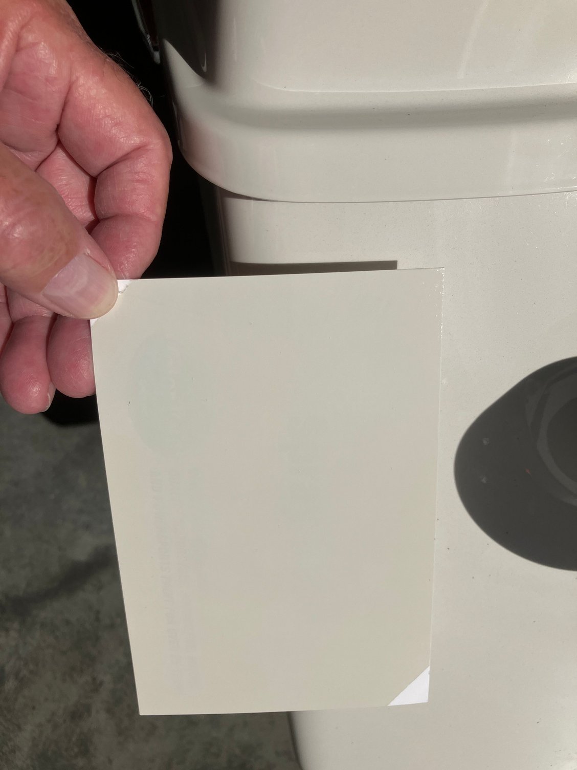

Paint came in. Did a spray out on the test card they sent. I’m really pleased with the color match even though ColorRite says *Factory Variance* on this particular color.
The color coat laid down perfect on the test card. I mean it looks perfect in person. The sun is at a low angle being 3:30 on the east coast. And there's some large blue print on the card you can see through the one color coat.
Then I shot some clear over it, and that did exactly what I expected rattle can high gloss clear to do.
Show. every. little. thing. Stuff that wasn’t even there when I shot the color coat. (ETA- Looks better now that it has dried.)

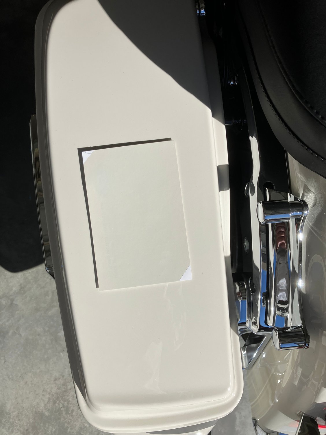

After shooting the clear. Can’t see the blemishes at this angle, and the hard bag has some road schmutz on the back of the bags, but this should be the color after I primer spray the side covers with light gray primer.

It looks a little darker to me, but seriously, it's so close, no one will notice it.
