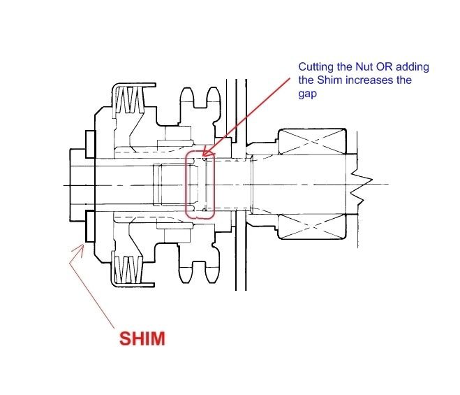

I have to wonder if the front 32t pulley has been changed out for a smaller one. That would explain why you are reaching the end of the adjusters right away.
Try this the next time you remove the outer primary:
Remove the compensating nut (40392-91) and add a .030 spacer shim (43290-82) because there was a service bulletin stating that the nut was too long.
