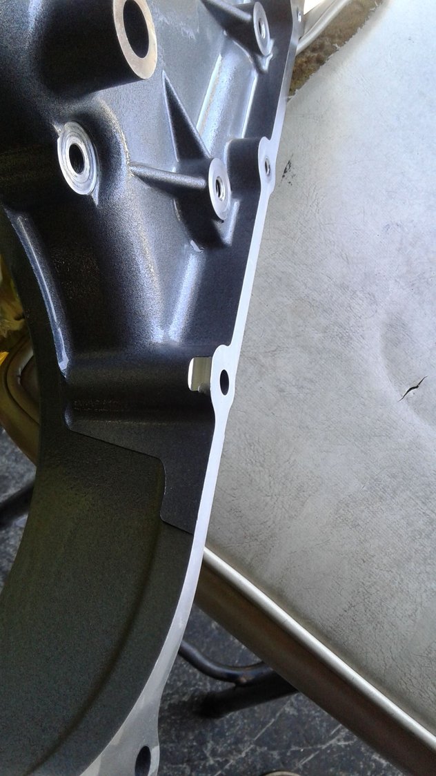

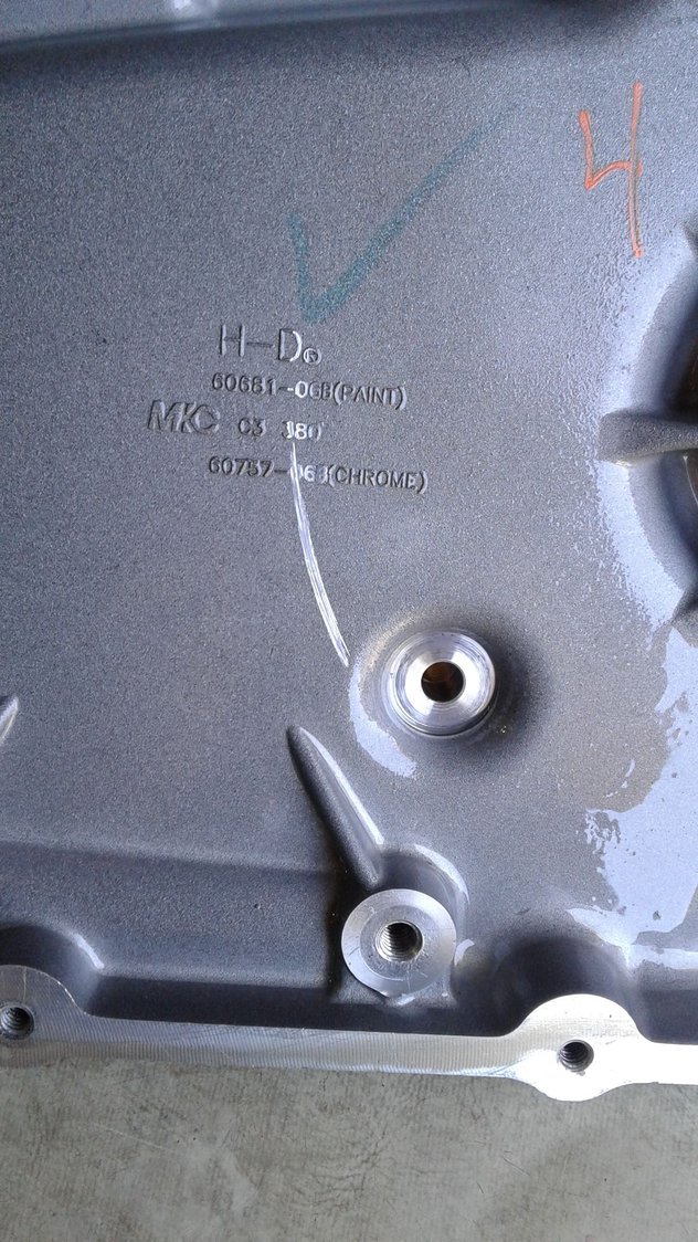

Another primary strip down today. Chain and clutch basket/starter ring gear touching the inner primary since the last build.
Chain near the lower front as in the photos attached. What is it with that I ask ?
Put in the updated Genuine chain tensioner to see if that makes any difference
Part # 39929-06B Noticeably "thicker" in the base than the OEM original.
Could have put in the Screamin Eagle manual but decided not to. ( Hopefully correctly !)
Still spring pack and /or roller bearing noise from the compensator as suggested before now.

If the ring gear is touching the primary case as shown, it's probably a good idea to replace the inner primary bearing. The may be part of you noise. If doing so I'd open up the oil feed hole to the inner primary bearing.

Had a real good "look" at the inner primary bearing , all seemed good. No roughness or visibly obvious wear points.
How do you "open up the oil feed hole to the inner primary bearing" ?
I am starting to wonder if in the first build I have inadvertently left out a spacer or divider. say from the rear of the clutch basket for example ?
I don't think so but have been racking my brain. Funny how the mind works sometimes

With a counter sink or center drill. There aren't any spacers that go behind the clutch.

That scuffing of the inner primary face by the ring gear I have seen other photos like that , worse scuffed than mine.
Obviously that means it can be a "thing"
