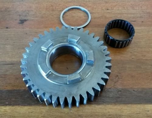

Like TWIZ says, shift while still moving. OK to coast down say in 3 or whatever you are in using the engine as a brake but when you get to just before it's going too slow even will off the throttle, hit the clutch and shift it to low. The only shift is dog engagement. Gear teeth are always engaged. Some do each gear for safety. I do that only if concerned and speed of what is going on behind me.
The gear shift on these bikes is either a sliding 5 or 6 tooth dog engagement. To align, it must be spinning slowly. Car manual transmissions have serrations and sinc brake cones that engage every few degrees, so they shift stopped..

You said in post one that "This happens more often if I coast to a stop in 3d gear. I experimented with coasting to a stop in 4th & 5th and the same problem occurs."
What I am hearing is you are at a total stand still. Engine running, clutch in. In say 4 or 5 th gear. Why if it did shift in the past without say rocking the bike maybe a tad was probably indeed the oil.

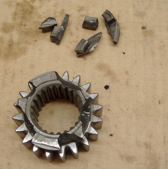

Formula + is probably, in my opinion, the best year-round lub for slightly less noise when you shift especially into 1st on cold startups. It's actually not making enough windage in your clutch like and automatic torque converter does. Nothing is wrong. Just do like it says in the manual and quit costing to a stop in gear or rock it to downshift if you do.
Newer bikes are really bad about this do to Harley's new clutch when people want it to do what you want it to do. Not really designed to do that. Those dogs have to move almost 72 degrees to do that.
Now you could make them narrow and it would do what you want. But then you would have this.
