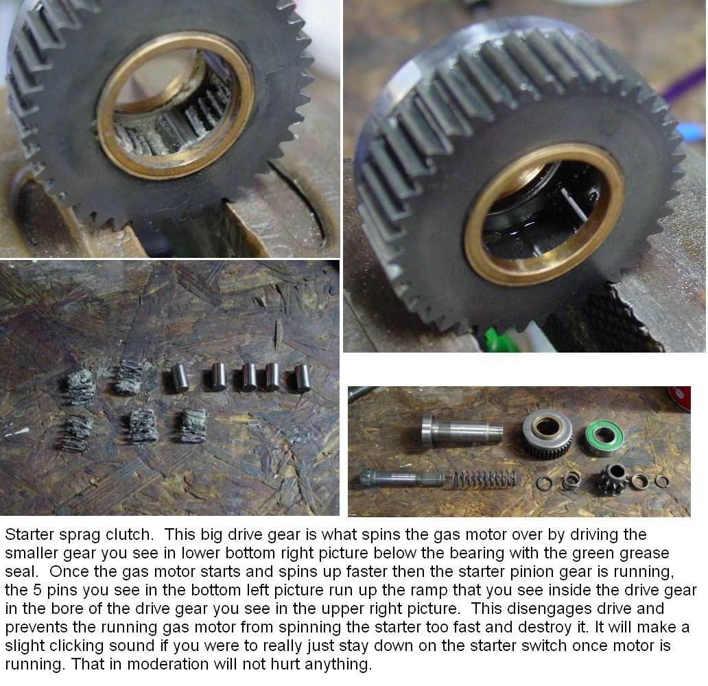

Anyone have a favorite brand?
Mine still spins fine but won't retract fully back and just sort of freewill on the clutch gear. I haven't taken it off yet.

Ok good eneough. I've used allballs on some 4 wheelers but wasn't sure if I should on the bike. And I'm pulling primary today to take a look.

It's a sprag clutch. The grease is dried and caked. You cain't wear one out. Clean it and grease lightly with high-temperature silicon grease.
