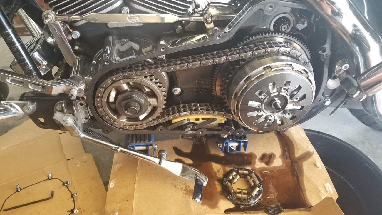

I too need a new compensator on my 2008 FLHX with 66k miles on it. I am leaning toward the Man-O-War as a local HD performance shop recommended it last time I dynoed there.
The PO did alot of performance upgrades on it before I bought it (113" hi comp, throttle body, injectors, T-man cams, SE tuner, blah blah blah).
I am pretty sure that he swapped out the original one with a performance on. Can anyone identify this compensator or tensioner? Screaming Eagle?

Looks like SE unit I have that took a dump.
And a stock adjuster, junk also, imo

The SE comp uses a Torx bolt, at least on the later 103's.

You are correct, I also have a torx bolt.
